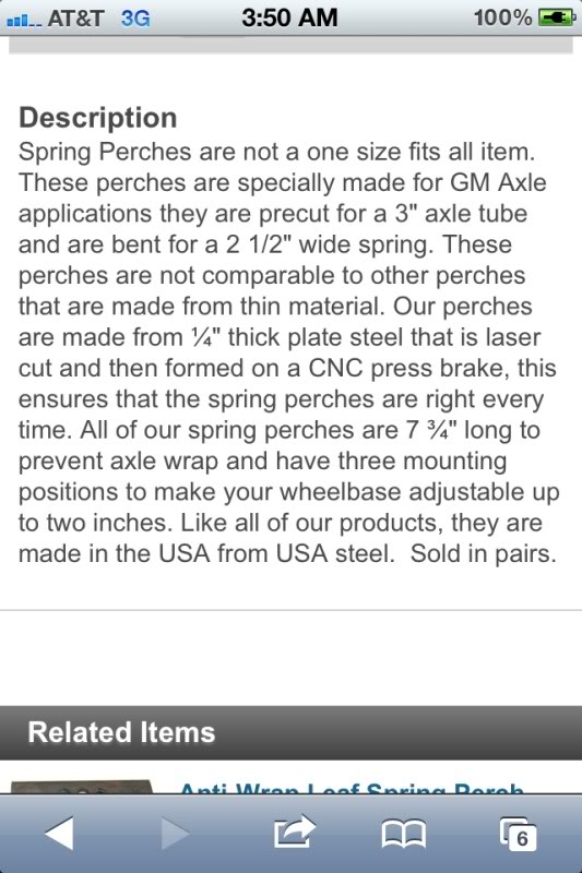

Mcg, Belltech are a cup style flip kit. The DJM (well the new style for my truck) is an adjustable clamp style. Imho its a poor design. It should have been a solid weld with good metal not stitch welded and cheap metal. As "cheap" as i call it...when you tighten the 2 bolts down it draws the top plate into the rearend and the "cup" into the axle. I see they put a "gusset" but that helps none. If it was me i would have made it out of some 4130 or thicker plate atleast.
As for the reason behind me wanting to do a new perch is because i dont like the idea of running 4*+ shims
Im going to bring my truck to a 4wd shop by my house that builds off the wall custom suspension. I know its not a drag racing shop but its the only option i have in the next 2 weeks unless i take off to go to Orange, Tx to see madman
Imma order these and look into having them installed.

Same as stock and half the price:
Mopar Performance Rear Spring Mounting Seats P4120074 - SummitRacing.com
