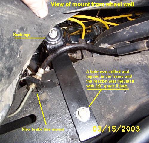

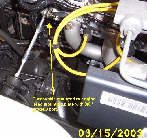

Check out these photos I stumbled accross... Home brewed Torque Strap, this was in a 1990 Chevy Truck...

I'm honestly glad he's gone LOL... a good tq strap or more rigid will put plenty more to the ground. that setup with the bushings and turnbuckle seems like it would be easy to try out and still not make it ride/idle like a pogo stick.

I have been in a creative mood lately so, maybe I'll build one like in the photos i posted...

that looks like it would work great.
