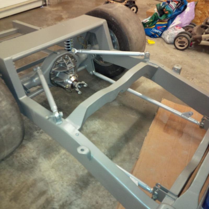

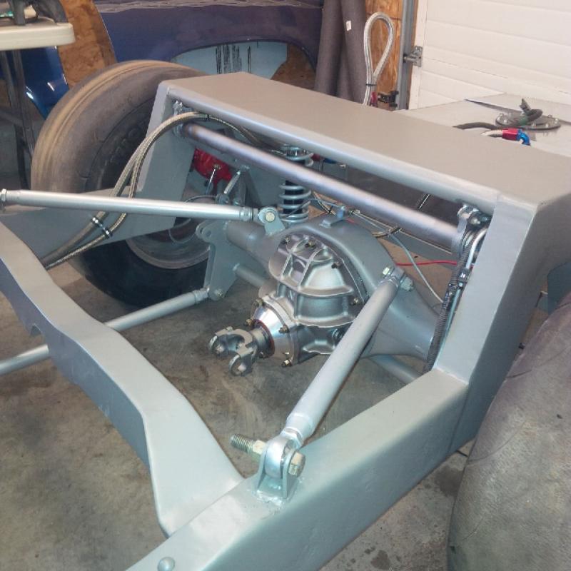

here is my brothers 92 triangulated 4 link
