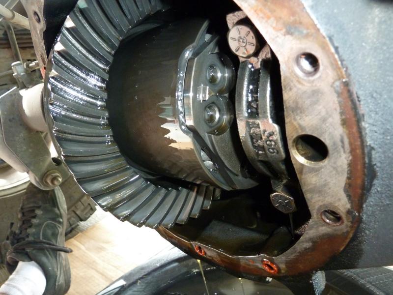

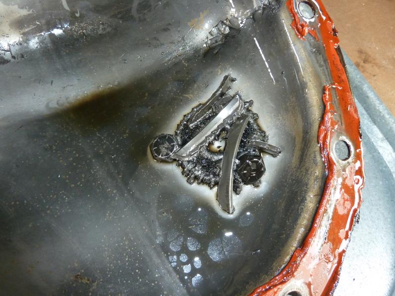

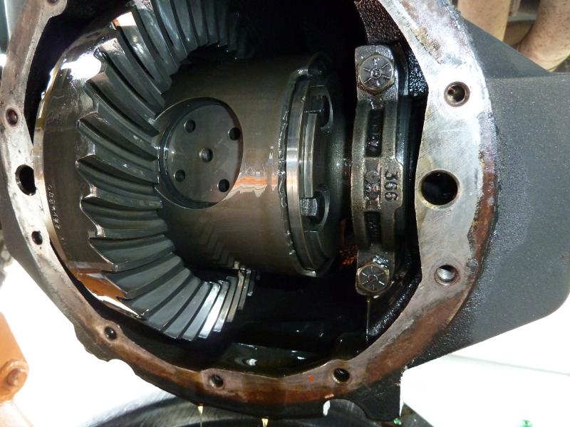

Heres what happened to mine with no racing. I DD drive my truck and pull a trailer. It also has 160k on it. I'll buy another one to replace it with. Still in the truck workin' for now.. lol

Went to put my 5 lug axles in the other day and noticed this same problem on the left side.. Couldn't get the c-clip out..
Also been noticing the LR quits spinning during a burnout ..
