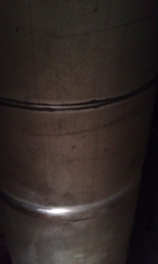

I need one too,I called driveshaft specialists today for a quote but need to make the measurements for it. I lowered my truck and somehow the stock dshaft was rubbing against the xmember holding the gas tank. Name:  IMAG1235.jpg
