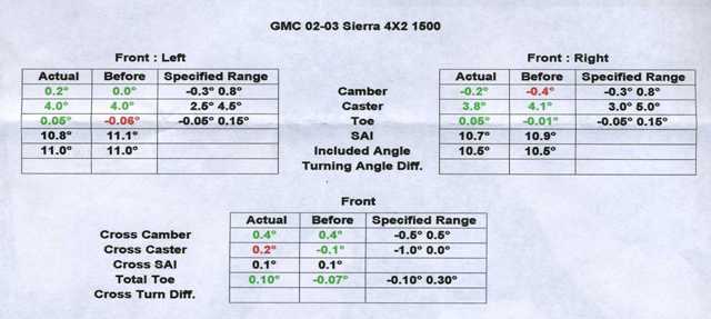

This is what you need to look at on your alignment specs. Surely he gave you the print out.......
Look in the middle of the specs.
You should see: cross camber
cross caster
total toe
Now, what does it read exactly next to cross caster? If it doesn't have at least a -.08 to -1.5 cross caster, then it will pull to the right.
The toe and camber spes have nothing to do with your truck pulling to the left or right. If those are out, it will only wear out your tires prematurely.
I do alignments.
Let me know what your specs are reading. Then we can go from there.
Sometimes a tire can cause a pull. It's called a radial pull. If you don't have directional tires, you can just swap the two front tires from side to side to see if that changes your pulling issue.
Just tell me or paste your alignment specs here first.

Ok Jim attached below is a scan of my alignment specs. Great to have an expert alignment guy help me out with this.
Now an important point to consider is that these tires are brand new (recently mounted and balanced) and my old set of tires (the exact same brand and size) also pulled like this. When my trucks tires were recently installed the guy putting em on said my brakes looked o.k. (I asked him to look since I have never replaced them with 27K on the odomoter) yet I do hear some squealing occasionally. Regardless of this fact the brakes are very strong and give me no trouble during extreme driving, so if it was a brake problem I would be surprised.

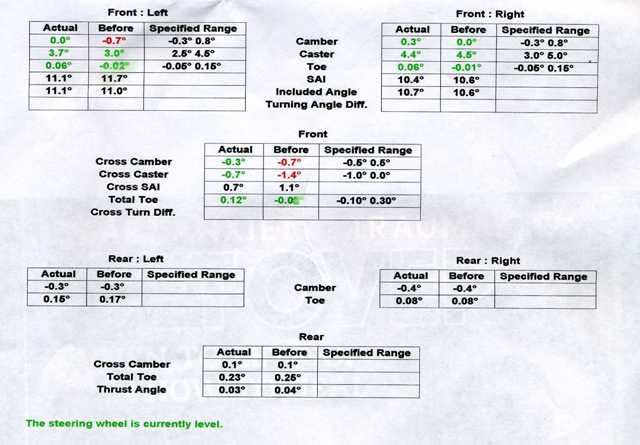

I was/am planning to go to another shop to see if they can fix the issue. Also attached to this post is another print out of the alignment job the guy did the second time around.
I then went to another shop and explained what had happened. This guy said since the previous mechanic had aligned the truck to specs that he could charge me to do the same again but that I probably had a bad tire, which was causing radial pull. I still find this hard to believe since this same problem occured with another set of the exact same tires. Personally I think the odds of having another bad tire in the exact same place are way to slim. I am about to go on a 1200+ mile drive from Cali to Lake Tahoe and dont want my current setup to cause any premature wear. Do you all think this is anything I should worry about in this amount of miles?

The second print out looks a lot better. The first on was obvious why it would go to the right, but why are the befores so different from the first time??? Makes no sense to me unless he began adjusting prior to saving the before alignment settings when you came back.
I'm sure that the second time around helped out with the pull to the right?
Your still going to need a more negative caster split.
At least a -1.0
Some of these techs just don't know how to deal with lowered or altered trucks. You can align most vehicles correctly without even having the manufacturers recommended allowed specifications of to the left on the print out.
I'm use to that print out that you posted. It's identical to ours. Same digital alignment machines. Hunter.
At least a -1.0
I'll post my print out later. I'm in a rush and have to go.
Jim
Yea after the second time the truck definitely is better, overall far more tolerable. Looks like I will have to find a good shop experienced with alignments on lowered/modified vehicles. So should I worry about tire wear on my trip?
