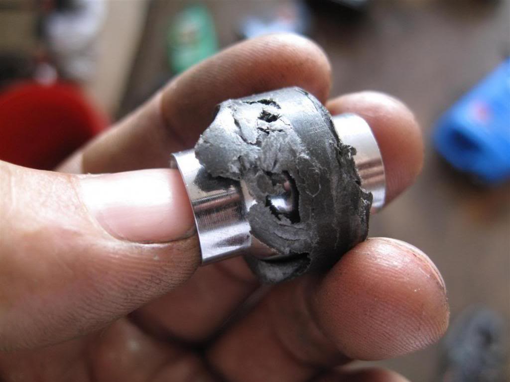

I bought some of the stud conversions to mess with and its pretty much exactly what I thought, takes off 1.5" of mounting distance...
What this means is you could go 1.5" lower in the front by simply changing the top mount, which would put my front fender height at roughly 30.5" which is pretty low IMO. Alternatively you could run the slightly longer ds303 and have more travel and less spring while sitting level.
Also, the "bearing" style mounts are not very good. I talked to qa1 and they are only rated for a 650lb spring, and this is why after about 10 miles:
I ordered some replacement steel bearings for $6 each. He also highly recommended I use a chassis bump stop so I got a universal one off summit for $8 to test out.
