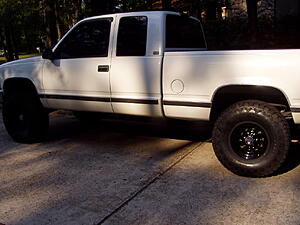

Here is my 95 C1500 with 6" lift and 35s.

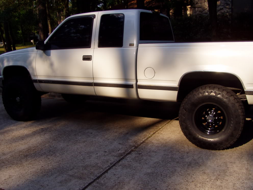

Here it is with the same lift on 33s.
I recommend 8" wide rims with 3.75" backspace minimum. This provides a good balance with aesthetics and wear.
