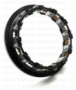

Pulled the trans today. I would say the small plastics bits in the pan are about the same size as the narrow ring on the overrun roller clutch. Of course there are also small flakes of aluminum, etc.
