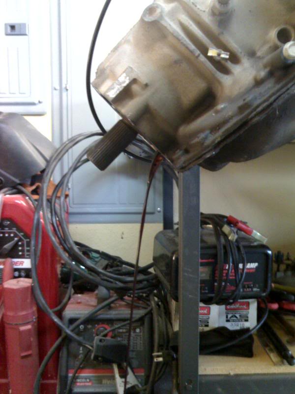

Like many 4l80E's the drain plug on the pan was stripped but drainig it was possible w/o making a mess of the garage.

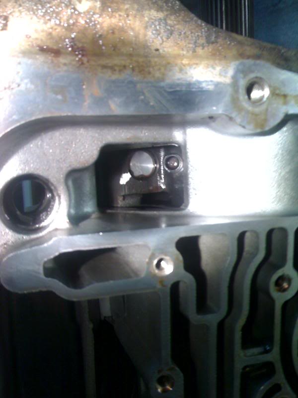

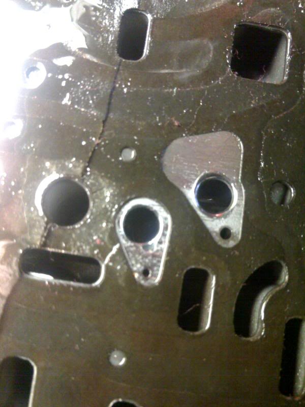

This is the wear the check ***** cause to the holes on the valve body seperator plate. The transgo seperator plate is a tougher piece.

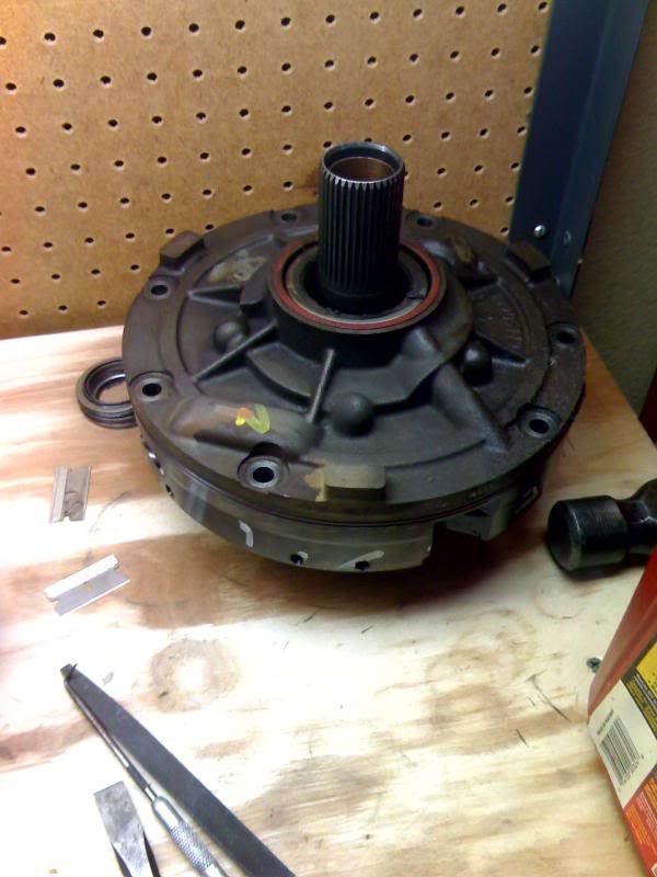

The manual calls for a puller to remove the pump assembly but you can put a prybar through this rectangular hole and gently pry under the pump to remove it.
I got a little carried away during teardown and forgot to take pictures showing every snap ring and what not but the manual is pretty clear as far as that goes.

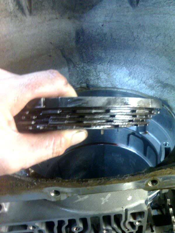

4th clutches and piston
removal of 4th clutches and piston assembly

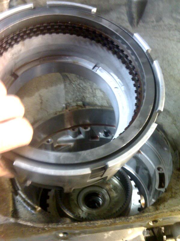

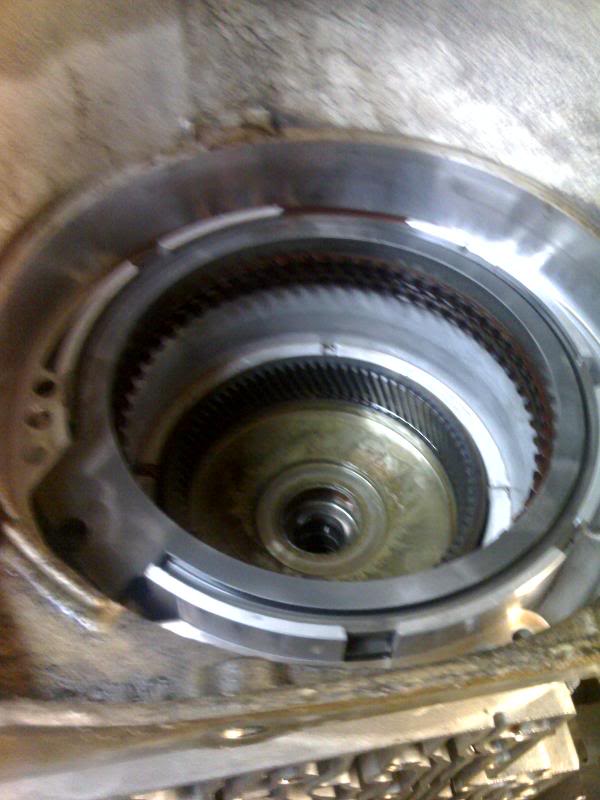

Removal of forward clutch drum assembly.

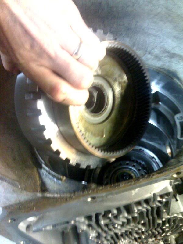

Direct drum/ clutch assembly removal.
Next you remove the intermediate band and intermediate clutch snap ring.
now the intermediate clutches come right out.
Next you remove the center support and gear train. There is a bolt which holds the center support to the case. I removed it durring the valve body removal This bolt will be replaced and should come with the overhaul kit.
Also the manual is not very clear on this, but you do need to remove the cooler line fitting because it extends into the center support.
center support and gear train on work bench during reassembly. *NOTE the round hole in the side of the center support is where the cooler line fitting seats*

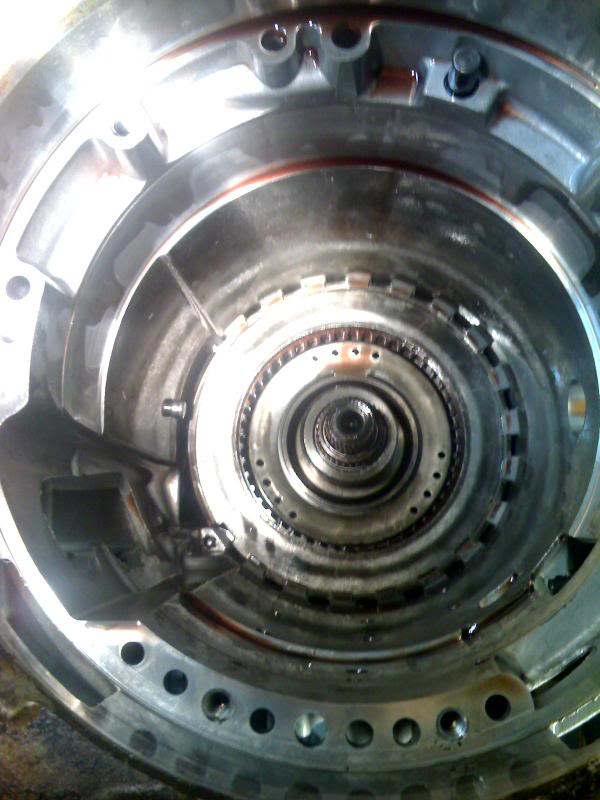

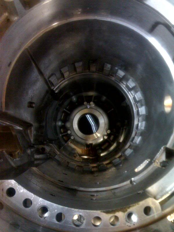

At this point you can remove the center support spacer and rear band, which is now just sitting in the case.
hear is a pic of the inside of the case w/ everything removed. There is a selective thrust washer tha sits in the bottom of the case at the tail shaft hole. Remove it if it didn't stick to the bottom of the geartrain.

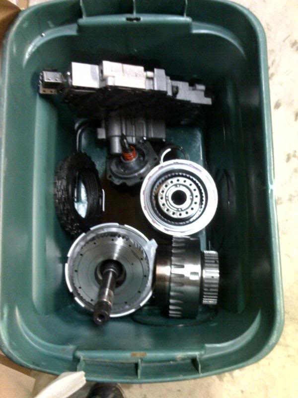

Here are the drums and valve body sitting in a tote waiting to be rebuilt.
here's the pump

here's the pump

Great work. I will be doing the same rebuild shortly, this helps a lot. When you re-assemble you can use torlon check *****, that will prevent any future wear on the case and separator plate.
