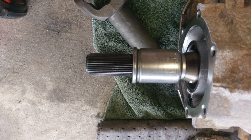

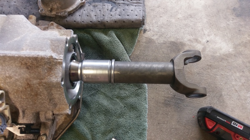

Instead of making a new thread, can someone help me with the yoke?
85e I discussed earlier from a van. Came with slip yoke that has the weep hole. The "cup" on the output shaft leaves very little engagement splines for the yoke. It may be plenty strong enough, but can I remove that cup and just run the yoke? Could I weld up that pin hole, or does it need it for the in/out movement?

I would remover that cup and weld up the weep hole. That trans probably had a short bolt on yoke on it.

There's no bolt hole on the output shaft and this is the original yoke from the van. I won't be making huge power but it seems like more spline engagement the better. I forgot to check if this yoke could even slide in further with the seal and extension housing on there. But I'll be making a custom driveshaft so I would like to get it right the first time
