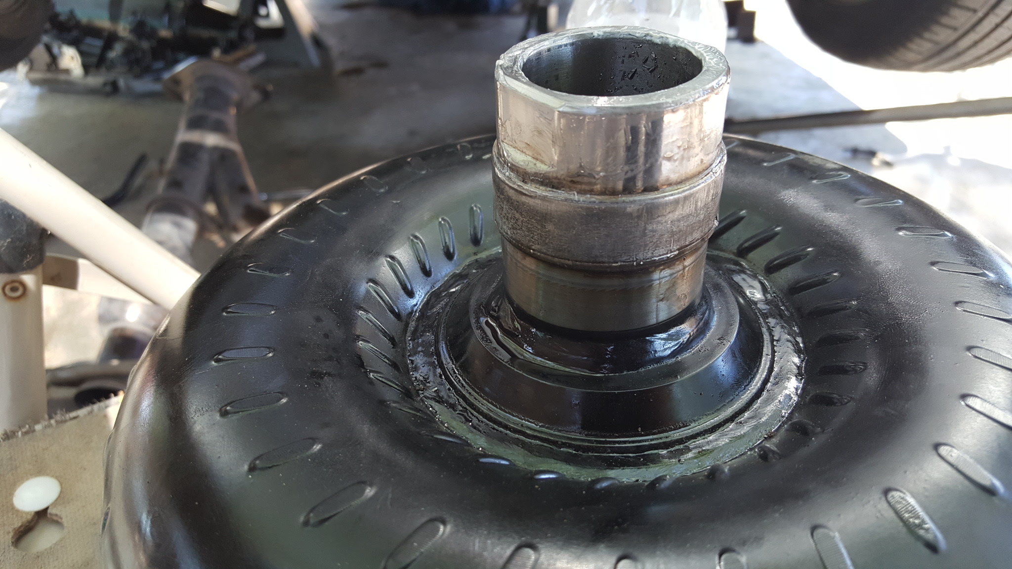

so i end up pulling all plugs and no luck so after all i pulled the tranny back out and man it was really stuck what happen was that the pump bushing came apart and spund on the converter till it end uo welding its self on to the converter and stop the engine it its tracks which i still cant believe i didnt break anything else i mean its bad as it is but could have been worse
nowni need new pump and send the converter back to circle d to get fixed which idk how much it will cost me yet
motor fine spins freely now

I wonder how screwed your thrust bearing in the engine is after that....still recommend pulling and cutting open the oil filter.
