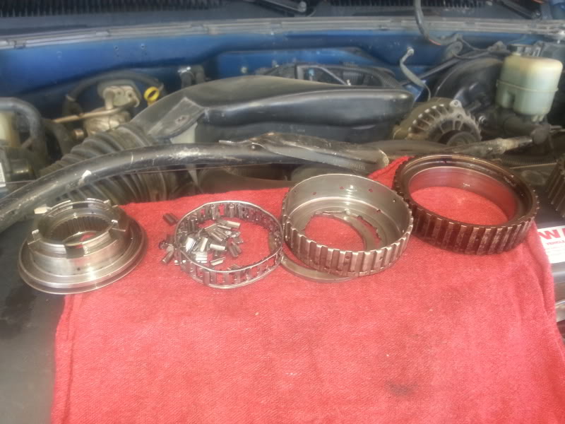

i just ordered a beast sunshell and double cage input sprag, along with a heavy duty rebuild kit with a kevlar band
this is what caused the pull out and tear down

With the broken over run clutch hub and the combination of the rolled input sprag, I'm going to guess that you like to manually downshift your trans! It looks like a stock single caged SKF sprag which is prone to fail as well. Make sure to get the Borg Warner dual cage sprag on this build.
