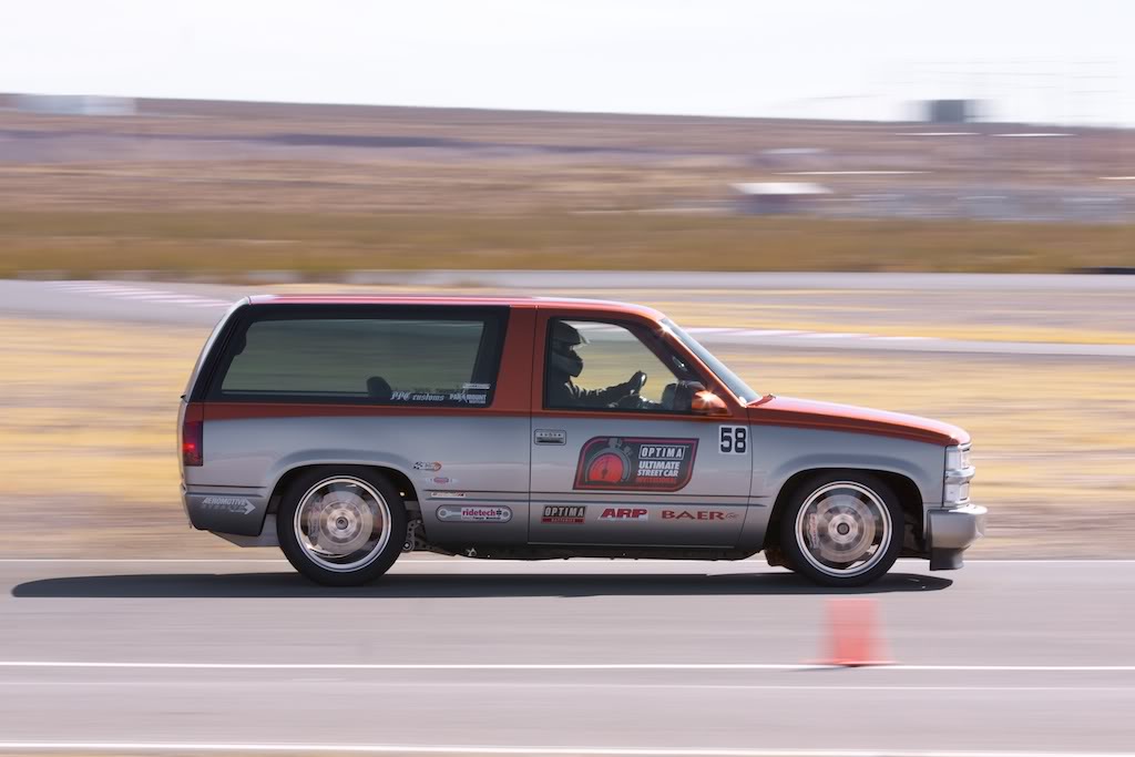

Very cool ! there has been allot of debate around the shop and my choice to include a 4l80 in my 6.0 swap and the "POWER LOSS" looks like I made the right decision Thanks for the infoName:  OptimaTahoe4.jpg

That Tahoe Is a beast!!! Glad to see you join up over here.
