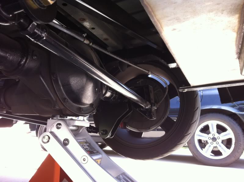

my brother is running adjustable QA1s with 200lbs springs I do believe in the rear.
bars inside
was 470rwhp
Ford 9"
street and strip
custom made
