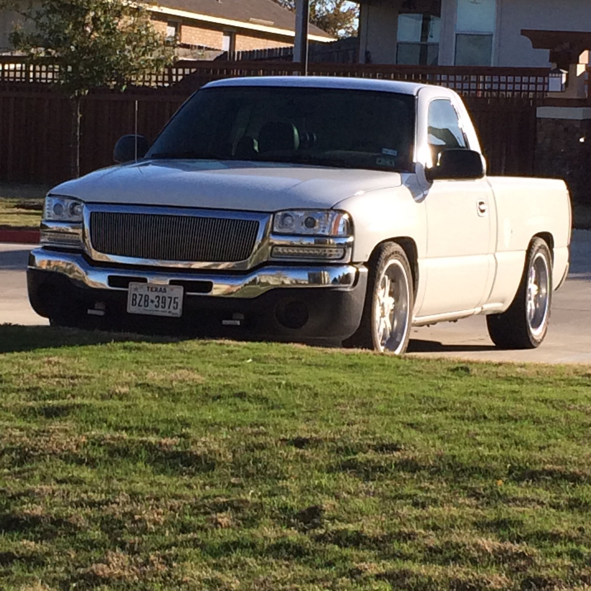

what kind of rims are those? i really like them

Nice truck. Question.. What brand of wheels are those?

i have a 3 /6 but sits like 3/5 cause lighter rollpan no spare and new leafs ... easiest is 3 in front spring and rear flip with lifting hanger and shocks to match or spindle spring combo in front whatever floats ur boat
