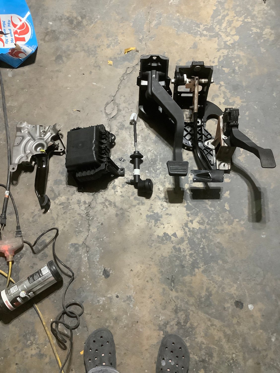

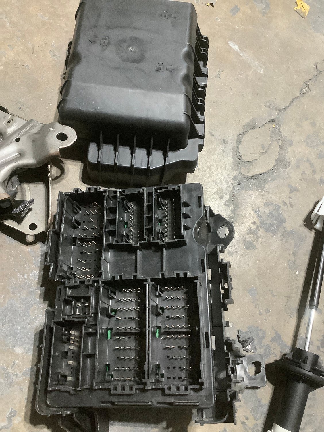

So I got a 2018 silverado and a t56 I put together I’ve got almost everyone and sorted out except what to do about the body wire harness junction box that’s in the way of my clutch pedal I’m using the factory assembly for, the earlier trucks. Trying to see if anyone’s got some ideas? I’m trying not cut deep into the wiring if I don’t have to.
I bought the 2023 gmepcmx (GM México parts catalog) as these trucks were offered with standard transmissions from 2014-15 behind the 4.3L rcsb trucks so I could at least view the parts diagrams to see how/what gm did the accommodate the clutch pedal but my computers not able to run the program.
The pedal bracket clutch pedal bolt right up master cylinder looks like its supposed to be there nice factory appearance, I built a tubular crossmember the factory would work I want to free up space with the turbo stuff.

What does yours look like? My NBS is a manual, and uses the same panel as the automatics.
What about trimming yours down to fit, and using a custom connector for what has to be moved?

here’s all the pedals and the junction box there’s . The vin might be useful I appreciate it. Honestly the hard part is any actually get to legitimate websites based in Mexico with a U.S. based IP without using a vpn or something.

dude, i like you already!! you drink RC and are manual-swapping your truck because automatics suck. you'll want to cut off about half of that brake pedal, though.
