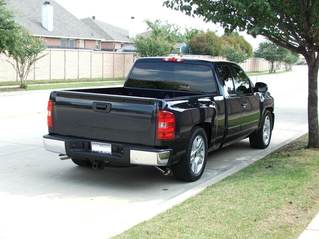

If you guys could send me picks of your 07 and newer trucks lowered with a 3 inch front/ 4 or 5 inch rear drop to help me decide how i like it, it would be greatly appreciated.

For a 3/5 drop kit i would recomend the new ground force kits there a little pricy but worth it and include everything for the install. I have installed a few of the Mcguaghys kits and there good but had alot of alignment issues and really didnt like how the spindles fit. With this drop you should be safe towing but i would suggest helper bags or air springs to help with the load. Here are some pics of some trucks I found online with a 3/5 drop...

This is the look i am after for sure, now my truck being a crew cab would require the leaf spring set up in the rear, which puts me around 1000.00 total kit, unless the flip kit will work on crew cab trucks. If it will next question is will this require the frame to be c notched? I have never performed this on any vehicle but i can bolt on the parts for the leaf kit.

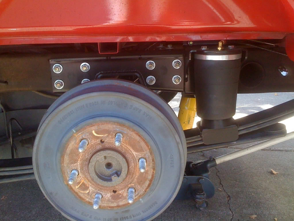

Now for the helper bags, you likely won't need them at 5". 6" you will want to think about them if you tow or haul much at all. The McGaughy's set are the ones you want, they bolt directly to the frame and use Firestone sleeve bags and brackets specific to these trucks, very easy to install and solid. They are pricey at about $375 but worth it in my opinion, very happy with mine. When I'm towing I just pump a little air in them and can get the rear up at least 2-3".

No problem towing with the helper bags, just have to go easy on the tongue weight (200-300 lbs):
