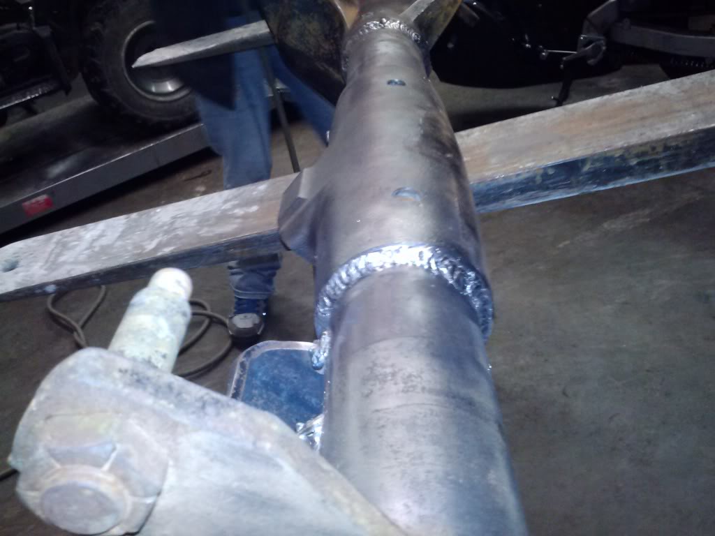

I think i have a decently solid setup, just rebuilt my front axle with a few upgrades, welded tubes, bigger u-bolt yoke.
My setup is LS1 Built 60E NP208 case 9.25 axle and dana 44 front. I feel the 60E is built right, NP208 is a low miles case but still chain driven, my chrysler 9.25 axle is big, but no real upgrades other then new bearings, dana 44's are said to be strong, wondering what issues 1/2 tons trucks run into with 400-500 rwhp running 1/4 in 4wd

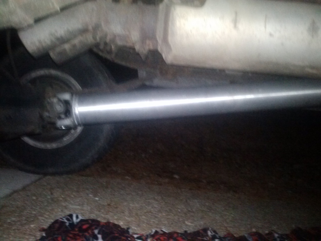

Two issues I have thought to be a weak link is the strap style yoke and excessive u-joint angle, I found u-bolt yokes for front and rear and my u-joint angle isn't bad I dont think
