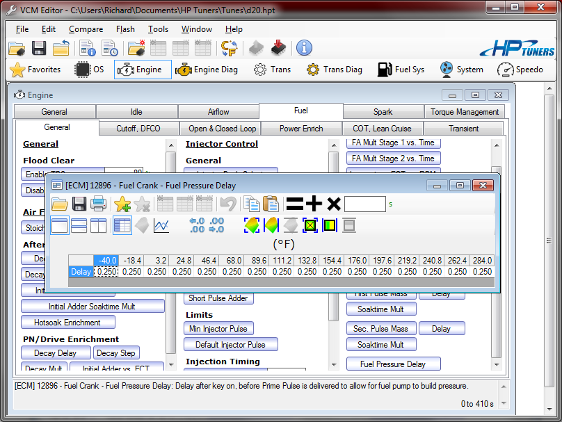

heres that table I was talking about, 2002 OS
Attached Thumbnails Slow bleed down adjustable fuel pressure regulators that act like a check valve?-fuelpressuredelay.png

My table is zeroed out. I thought that was the delay time before the pumps primed up when the key was turned on.
It says nothing about keeping the pump on longer in the description, only the time before it gives the priming pulse(s). Did you notice the pump run time changed? I read on another forum (I don't remember which), a guy said his OS had fuel pump prime time in the fuel system tab.

My OS has that.
