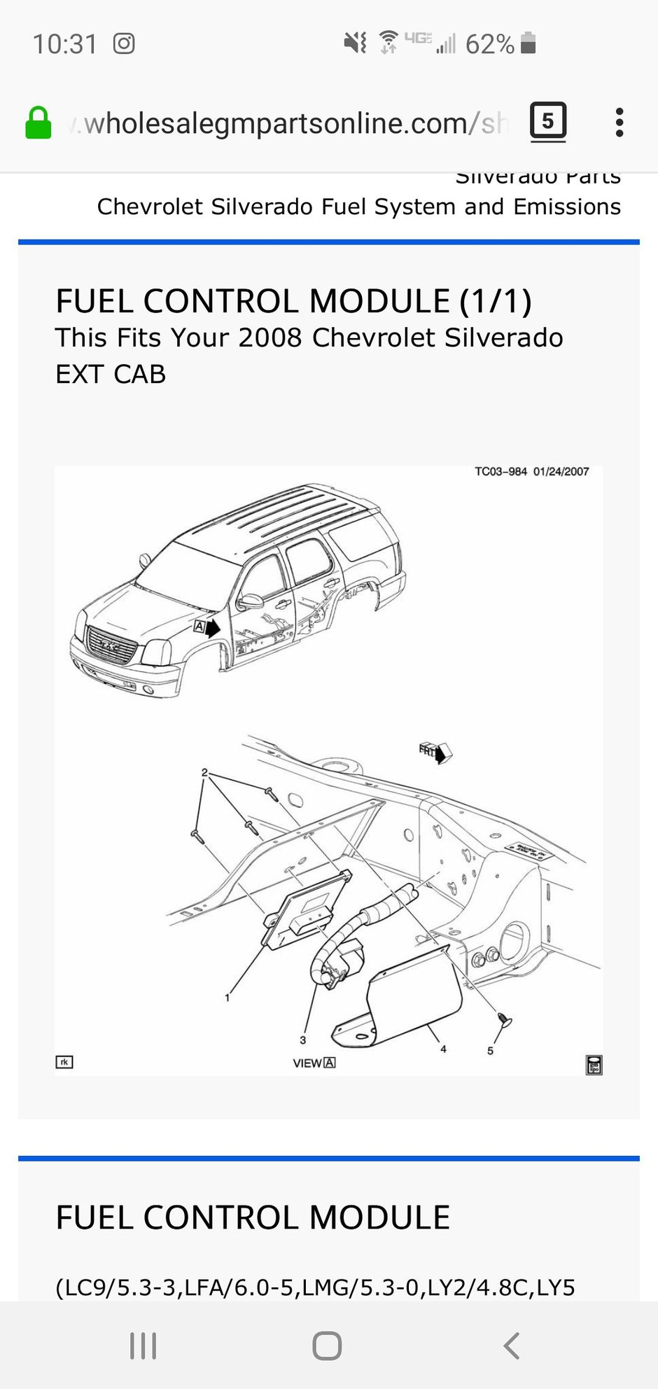

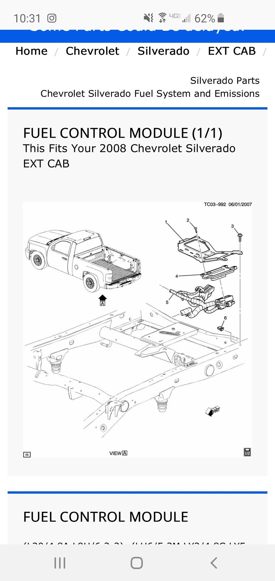

For those wondering about if they have an fscm/fpcm here are locations
I cannot tell by vin etc. The easiest way is in the tune it will say fscm/fpcm fitted (yes/no)
