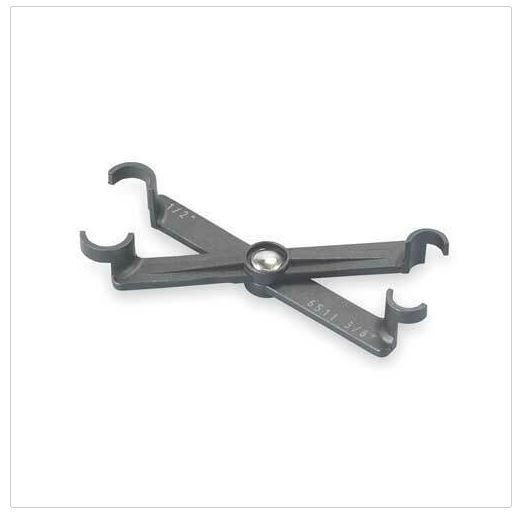

You ever done the fuel filter on a GMT800 flex fuel truck?
you have 2 tricks because the same problem exists
1) use the green plastic tool that sucks major pp
2) cut the filter and use a real fuel tool
if you go this route, I think you'll be cutting the sensor if you have to remove it. Or cobble together some barbed 3/8 quick disconnects and 6an fittings to eliminate the need for an internally sprung connector mating to the sensor
I wonder if this supposed "low-profile" one would work:
For only $16 I might just order it and try it.
