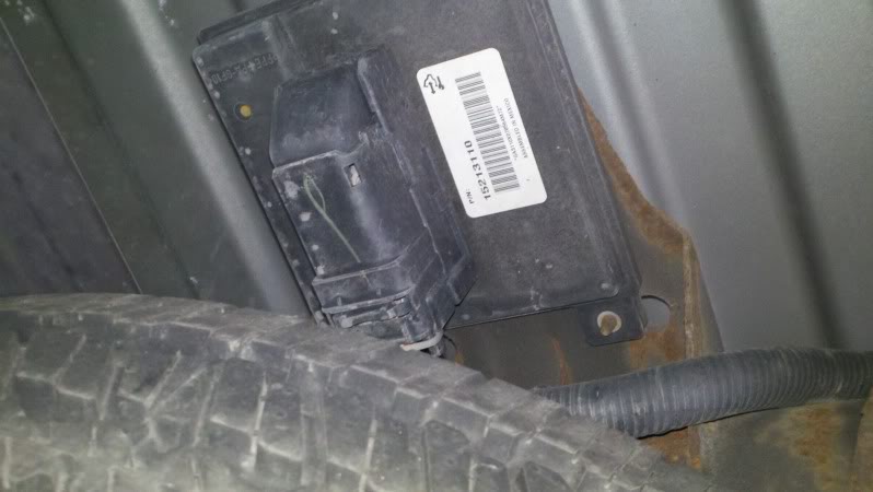

Is this the one? It was directly in front of the spare as you can see. Looked to be about the same size as the module you posted smokeshow.
Yeah that's it.
