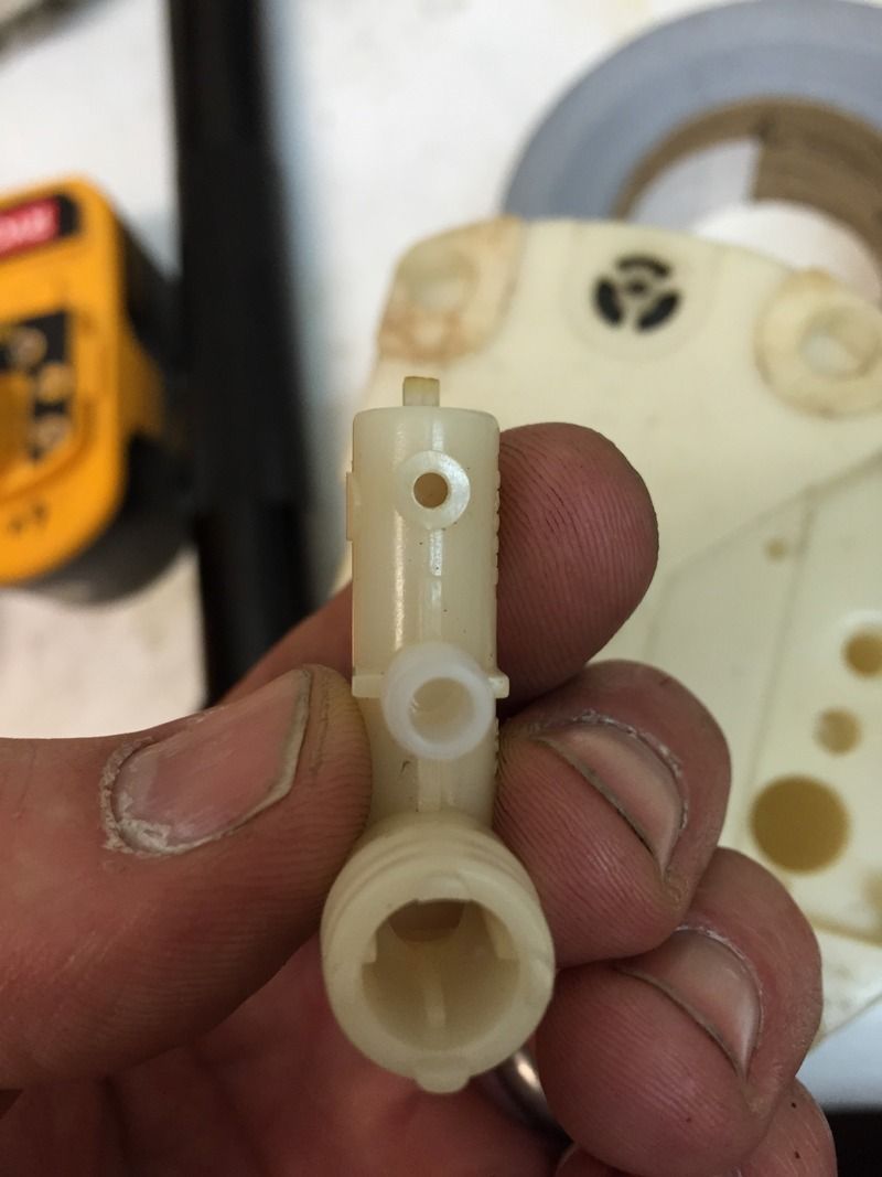

Yes I use it, what year is your bucket? I had to open up the hole in the Venturi as it was too small for the 450. Since opening up the hole it works just fine.

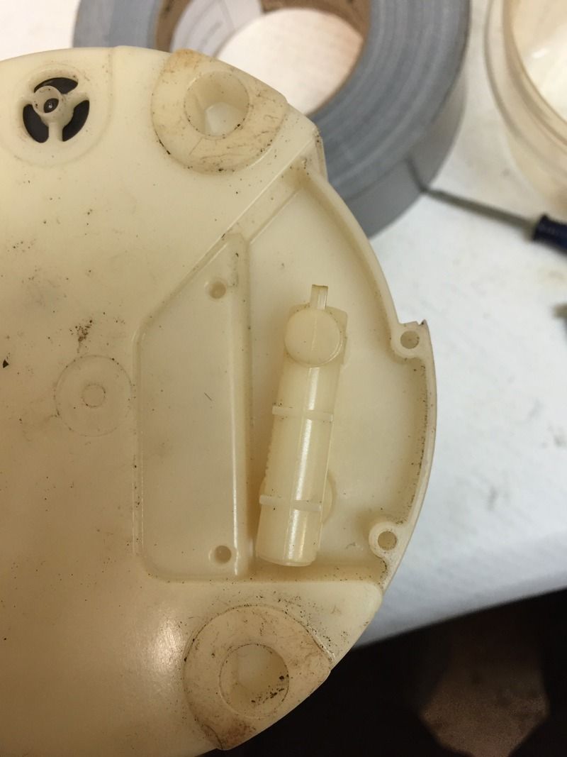

Bottom of my bucket
Where my Venturi pics up fuel, top hole I had to open up.
