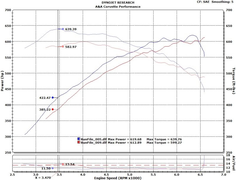

before/after nice hp gain across the board
