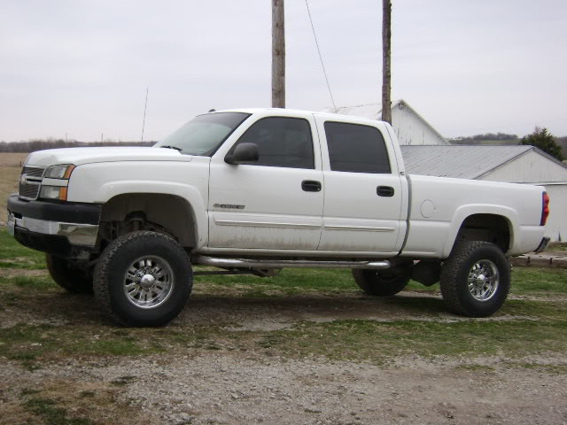

I towed for a couple of years with a KB front mount 70 kit in my lifted 05 K2500HD. The turbo was way outta it's efficiency range by 4k rpm/12lbs but it had no issues with quick spool and pulling trailers with ease. If I had to do it again it would be with a S475 either 1.1 or 1.36, like Kyle suggested. I'm actually thinking of building a tow rig and pulling truck with a 4.8/5.3 and a S475 with 1.1 hotside
What did you tow with it and did you have problems keeping it cool? Thanks for commenting also.

I pulled a 20ft open car, a 30ft bumper hitch round bale trailer, and an enclosed 26ft trailer. Never had an over heating issue except for pulling through the rockies and apalachian mountain passes. It didnt like the steep climbs and higher speeds. But it never over heated, just ran warm, with 05 elec fans and proactive settings in the tune
Thanks Joey this is the kind of feedback I'm looking for. I got the frame cut and the shortbed installed this weekend, next will be pulling the old engine and installing the 6.0/80e.
