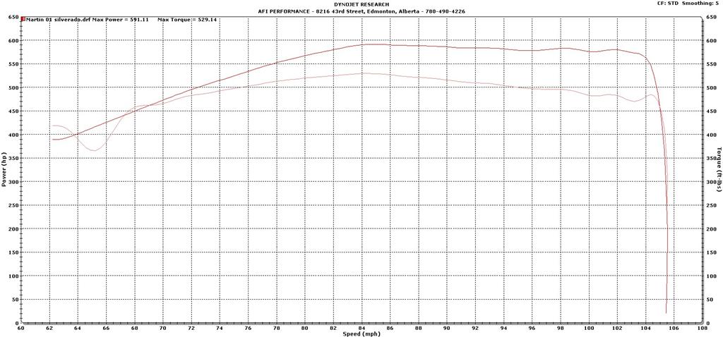

Yeah. Last week I got it on the dyno and couldnt run past 8 pounds at 5800 RPM before the fuel pressure dropped right off. I think one of the pumps in the Racetronix dual intank set up is not holding its own. I am back working on it this weekend though, so hopefully I can get some bigger boost runs going.
