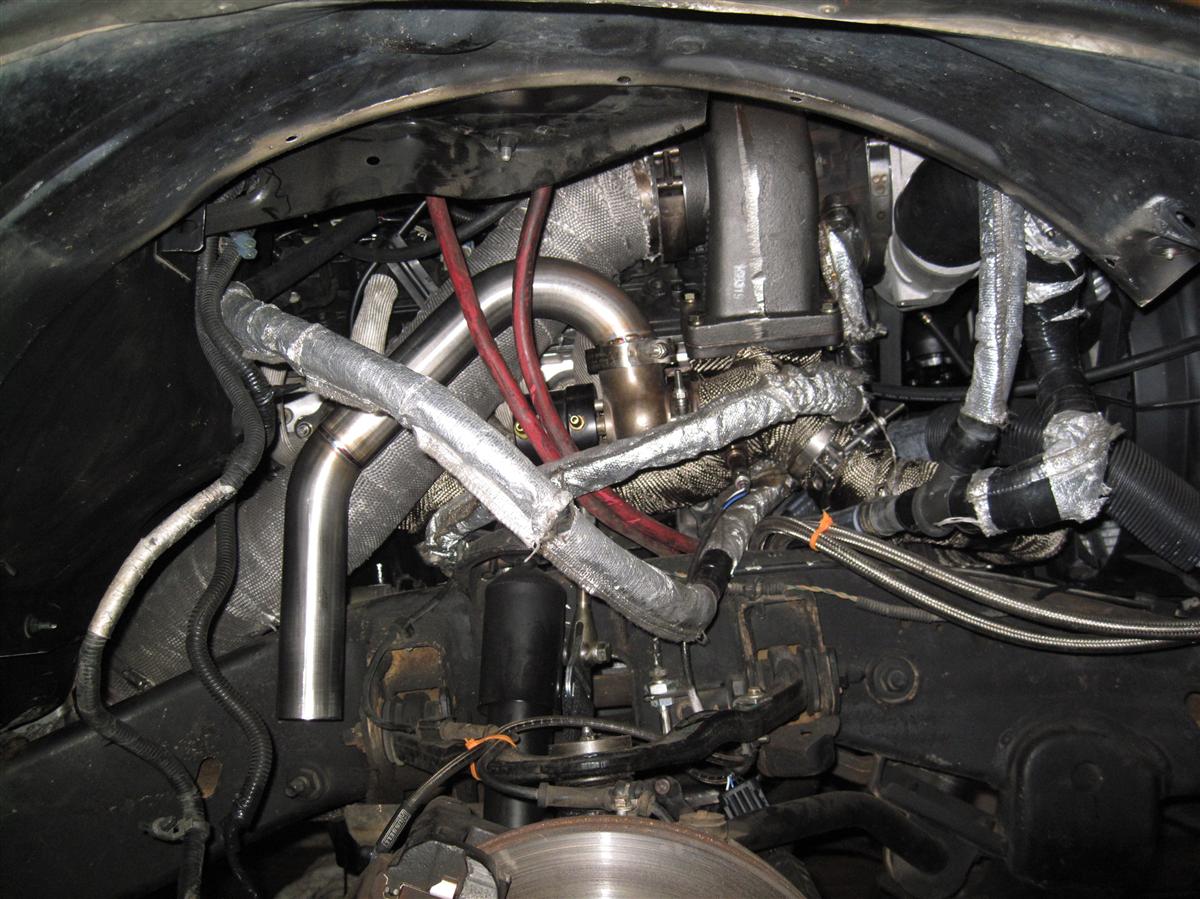

Did you ever finish this setup?
I ended up dumping my wastegate on my new hot pipes...
Partial throttle in boost it sounds like a harley is driving right beside me
At WOT everything is loud anyway, especially with the cutout
Playing with the boost controller, I can set the gate open pressure, so if I set it for 10psi, the gate stays completely closed then opens suddenly. So unless you are deep into boost it is pretty quiet.

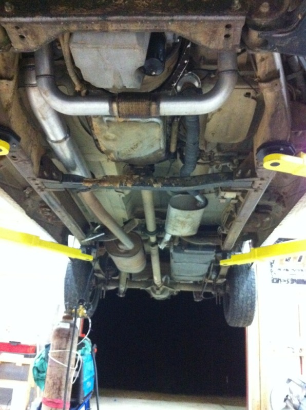

nonnieselman's Avatar
Joined: Oct 2004
Posts: 14,068
From: Crystal Springs, MS
yep.. super quiet
