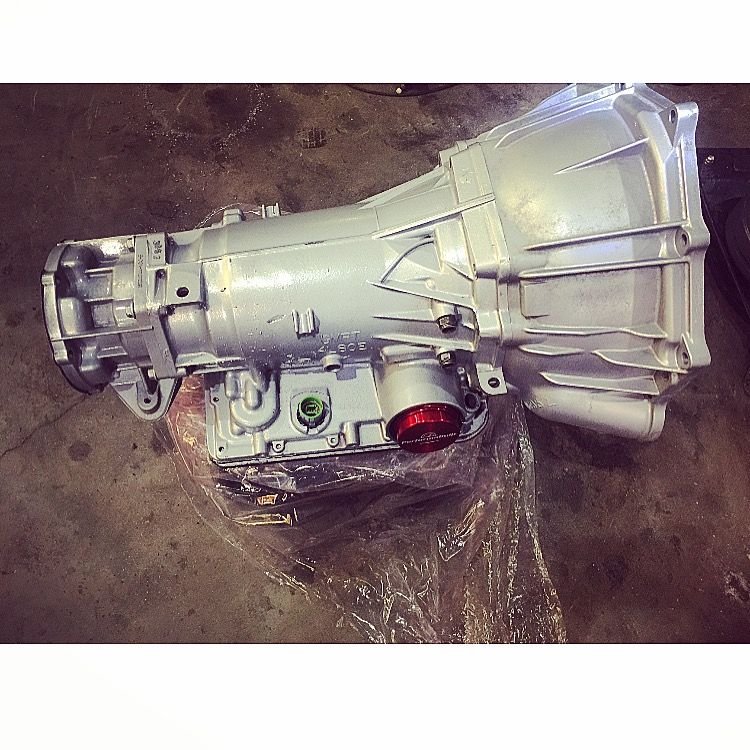

How's your trans been acting? Yo also need a wideband
