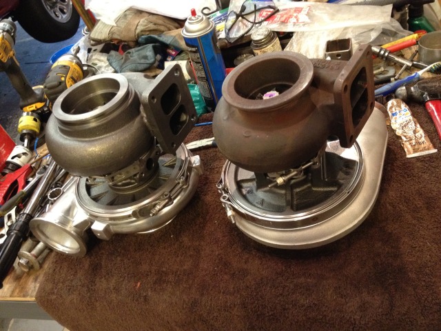

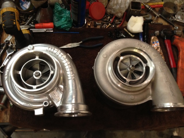

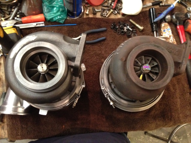

Left is a Magnum M480 and right is a BW S475...

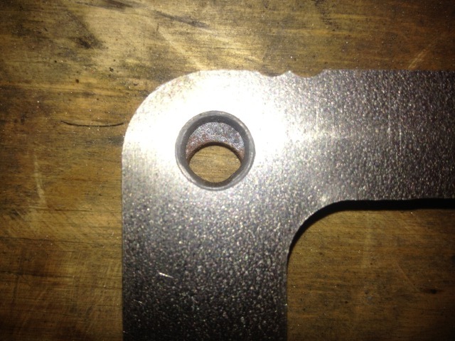

Flange difference...
