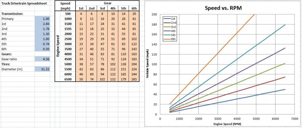

Here's the calculator I made real quick to pick my gears. This shows F-body T56 with 4.56's and 31.22" tall tires. 4.11's with 29" tires is virtually the same but a little taller across the board.

I am running 3.42 with an ls t56 and a 27 inch tall tire

alright guys I purchased 4.11 and hope to swap these out over the holidays. Also stuck in a Spec level 3 plus. gonna see how it works.
