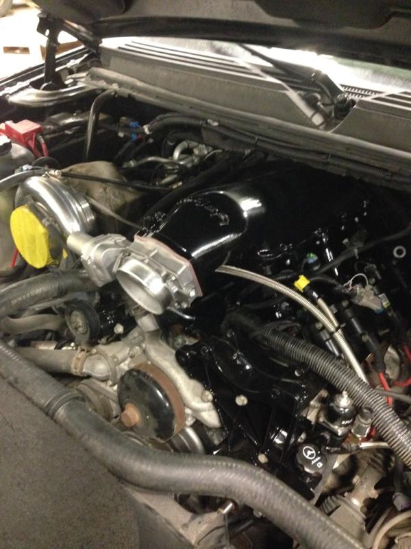

Need a new water pump now lol
I recommend a 2010+ Camaro water pump and idler. That is what i used. It moves the radiator outlet to the other side of the motor and a g8 gt upper radiator hose fits the combo perfectly.

Posts: 299
Thanks I will look into that.
