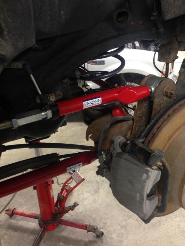

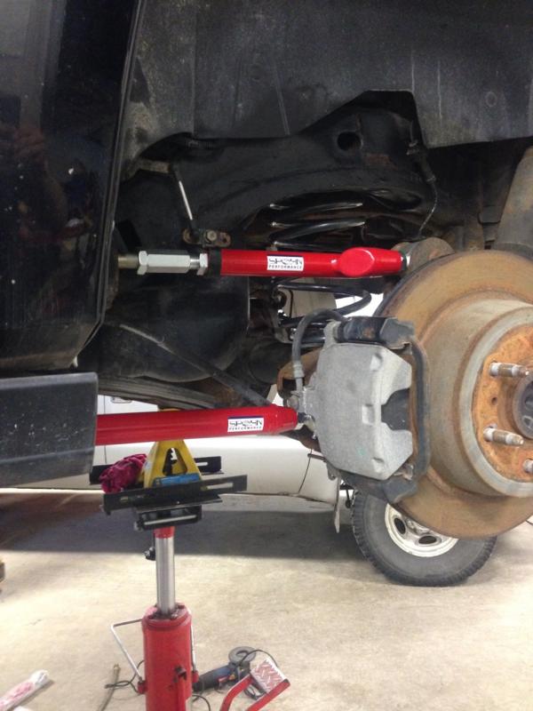

Alfredo Alfaro Sr. Jan 28, 2020 02:46 PM
Originally Posted by blownescalade62 (Post 5257314)
Upper and lower bars are on. Adjust axle in center and pinion angle. Free travel mod done and new bump stops installed. And lots of meth lol.
Attachment 96825
Attachment 96826
Attachment 96827
I'm also interested on buying those Spohn rear control adjustable arms. I have an 08 Escalade. Any rattling or noise? Thank you
