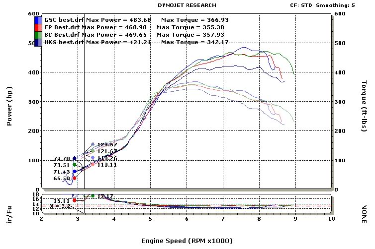

This is an example of the dyno graphs of big cam shootout I did a few years back. Same boost level, different cams.

Atomic, guys said the same thing about my cam test, but as you can see it works well keeping the level of back pressure (boost) the same. The manifolds that flow better will make more power at the same psi, that simple, and thats what most are looking for. If you want to then run less boost to have the same power or turn it up more and use that power is the builders choice.
If you don't add it back in its going to be very tough to see the gains, at that point all you have to graph is where boost was lost and at that point only guess how much power was to gain.
