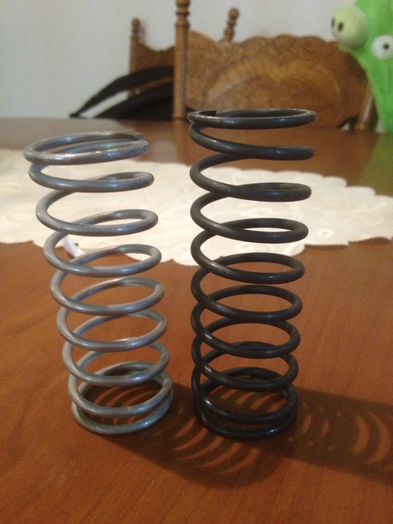

That is a good idea. Maybe I will just take off a coil at a time on the plain stiff spring that came with the kit until I hit the sweet spot.

How many coils are on the spring total? I would probably go slower than one at a time, maybe 1/4-1/2 coil at a time

Here is a pic of the stiff spring that came with the kit next to the Tial white spring :
