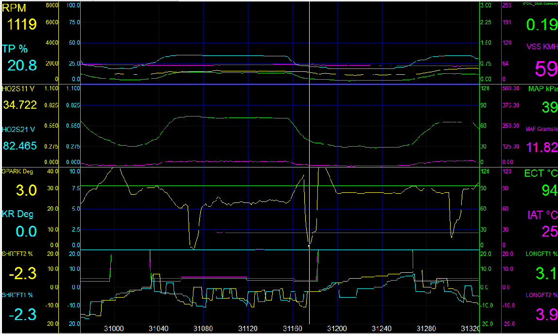

Not sure how that can is plumbed. Just ensure that no air that has passed through the MAF is ever vented and that no air that has not passed through the MAF is drawn into the intake.
Looks like some funky stuff going on with your timing just cruising even when there is no knock.
