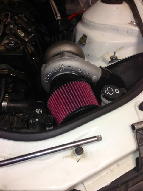

Thanks guy air filter came in ..
Fits just not like I want.
So looking at another one.

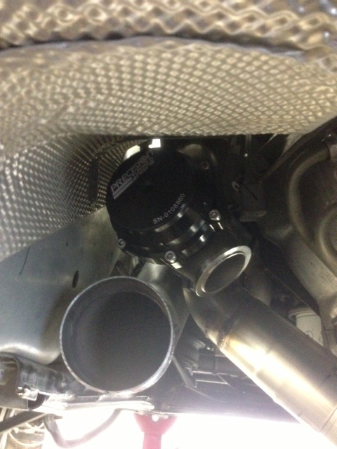

Got a little bit more done.
Down pipe is completed
And waste gate location.
I'm waiting in some more material so I can wrap up the exhaust.
Just about to move onto the fixtures.
