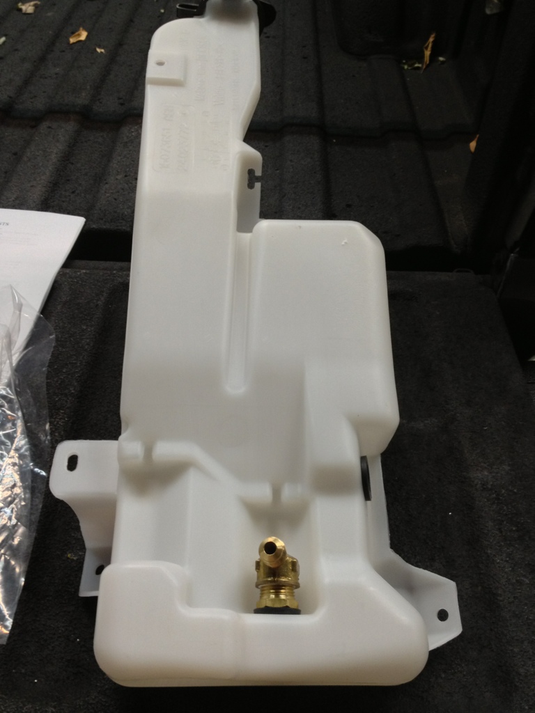

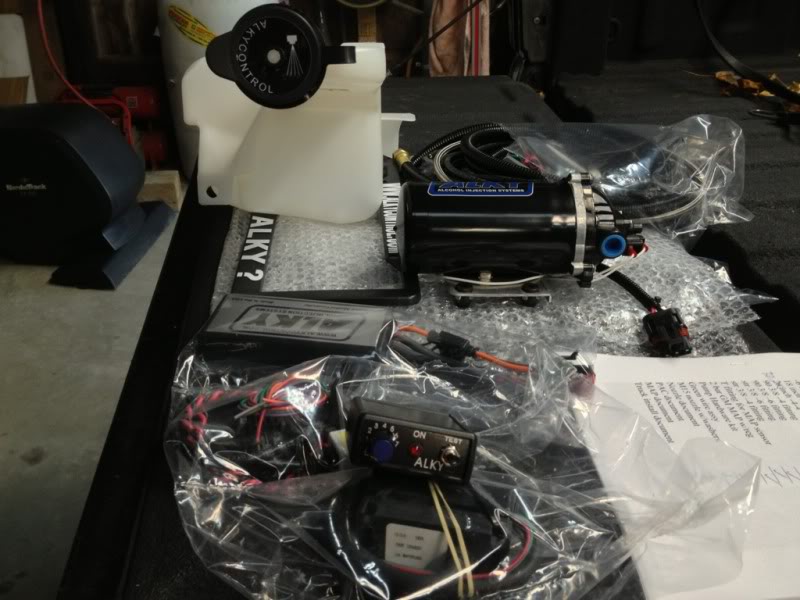

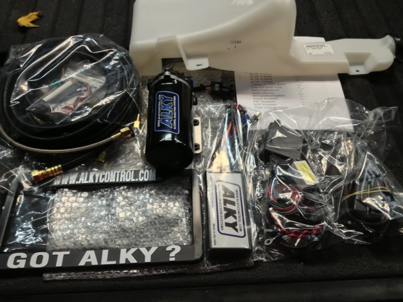

My kit came today , damn Julio builds a high end kit !

Sweet. More pics of the reservoir please.

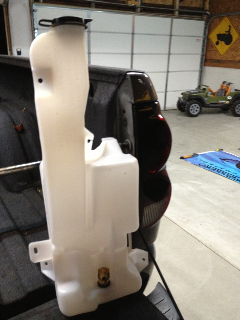

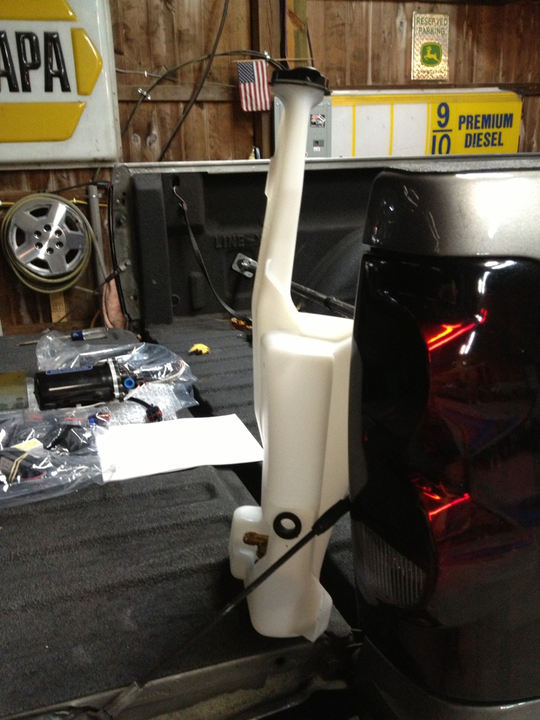

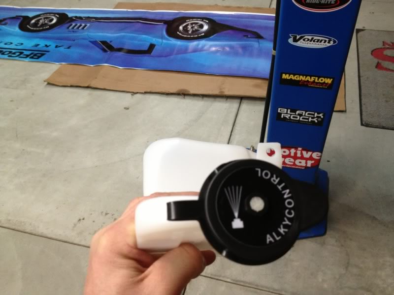

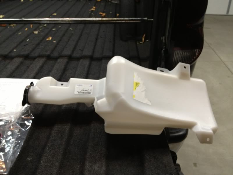

Ok , this post reserved for pics, be back in a few.
It's a new windshield washer res. from GM that Julio inserts fittings into, also utilizes the low fluid
warning light .

Oh that is freaking awesome!!

Yes I like that also , one less extra item under the hood and factory warning .

That does look like a nice kit. Maybe I will go with him instead of Snow

Hey that looks just like mine.

thanks , Julio said you can't run straight meth in a snow kit or others , the pumps are cheaper and need water meth mix . Just something to think about.
Yes it does haha ! Where do you think I got the idea from homie ?!

So tell me more about the kit.
Is it a progressive kit?
What are the lines made out of?
What triggers it, hobbs switch or map sensor or ???
What is that big **** for?
Sorry for stupid questions but i am really liking that kit

Progressive- Yes
Lines- Stainless braided
Trigger- Mine is triggered by a 2bar MAP sensor, you can adjust turn on pressure. IIRC mine turns on at 5-6psi, I think thats what I have it set at now.
Big **** is a gain adjustment, (Volume) in one of the other boxes you adjust turn on pressure and how fast it ramps up to full pressure.
