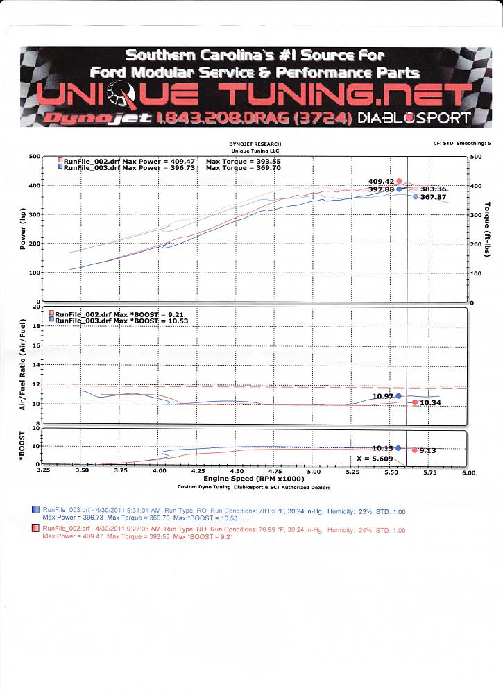

Im having the same issue it seems like. My truck made almost 500hp at 5krpms then flat lines. I was told valve float was probally the problem with the prc 650s I was running. I bought some comp 675s and the truck feels exactly the same but it hasnt been on the dyno to varify..

sorry that was an old dyno sheet.. I cant find the latest one but the graph is basically the same
Yeah yours to me seems better than mine. My power drops literally straight off around 5800. And it's very unstable looking to me all the way up, like it's not very smooth
