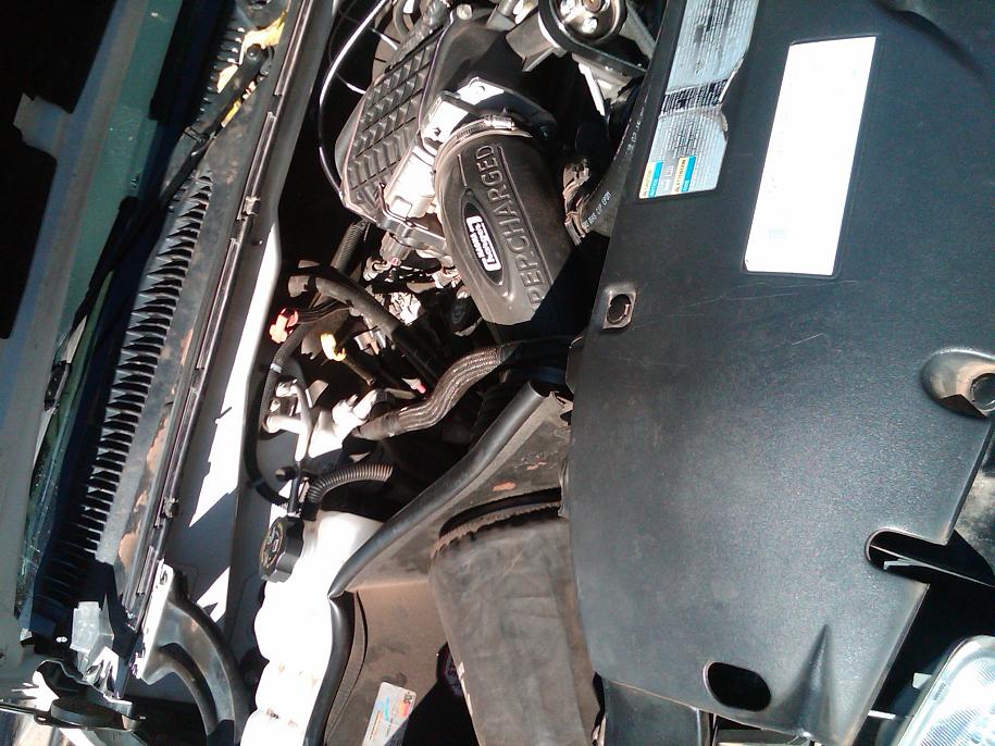

what does your air inlet and airbox setup consist of? Pictures would help

I don't know how to post pics bro. Has the k&n box. With the Maggie intake tube

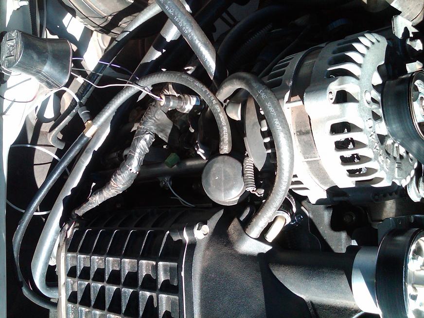

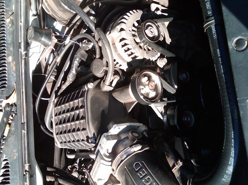

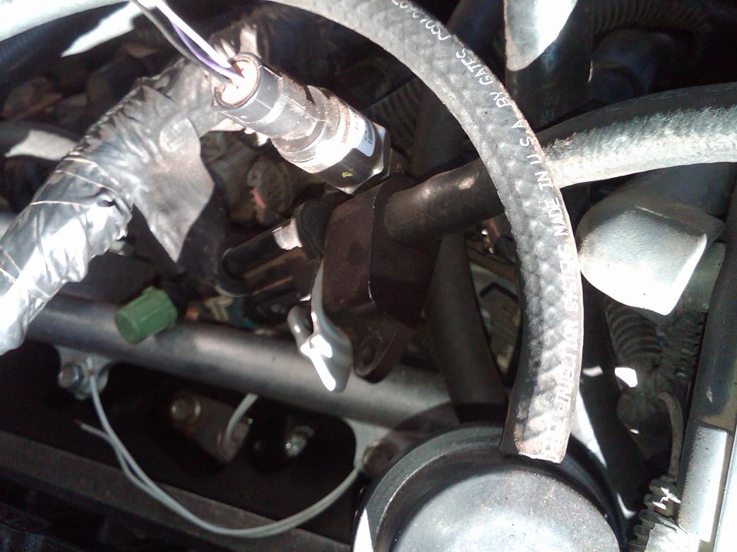

here are some of the pics idk if that will be much but i can get more on here
