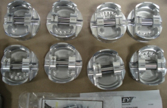

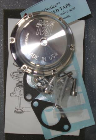

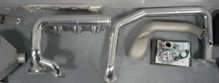

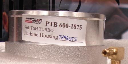

Tryin to see what you guys think this setup is going to put out. Forged internals 408ci, 76GTSH turbo, FLT 4L80e.
Erik from House of Boost in Kansas City is the one doing the build, he is on here somewhere if you guys have any indepth questions I am sure he will be glad to help you out.
Any guesses on HP/TQ ? 1/4 mile ??
I havent figured out how to load big pics on here so sorry for the smaller pics, I had to resize them all.

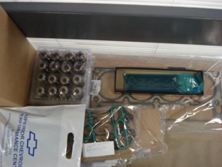

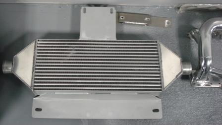

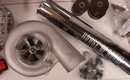

Attached Thumbnails Small turbo build what do you guys think?-gaskets-valve-springs-mini.jpg   Small turbo build what do you guys think?-intercooler-mini.jpg   Small turbo build what do you guys think?-turbo-top-view-mini.jpg   Small turbo build what do you guys think?-full-pic-mini.jpg

Got anymore details? CI, boost level, forged pistons too? What cam?

Anyway, not sure of the cam, custom grind from Comp cams, but the boost should be a conservative 15#'s. daily driver...
Forged pistons rods etc.. still postin pics..

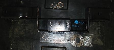

Attached Thumbnails Small turbo build what do you guys think?-1turbo-parts-mini.jpg   Small turbo build what do you guys think?-2turbo-tag-mini.jpg   Small turbo build what do you guys think?-3dsc00016-2-.jpg   Small turbo build what do you guys think?-4dsc00012-2-.jpg   Small turbo build what do you guys think?-6dsc00017-2-.jpg

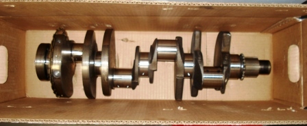

Everything has been balanced, if I could get bigger pics on here you could see it but the pistons, crank, connecting rods have been balanced.
I believe the compression is going to be around 8.5:1. Should be able to run alot of boost once I can afford some aftermarket heads. Any suggestions on the heads?

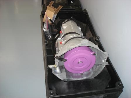

Tranny:
Street/Strip 4L80E Transmission from FLT stg 4
Transmission core charge
Precision Industries 9.5 inch, 3-disc 3200
4L80E 4-bolt aluminum inspection cover
4L80E shift cable bracket
4L80E Transmission dipstick tube
Bolt - 4L80E inspection cover
4L60E to 4L80E wiring harness adapter kit
NP3/NP149 transfer case input gear for 4L80E
Custom Built Cross member
Drive shaft modification, and rebalance
Motor: 408ci

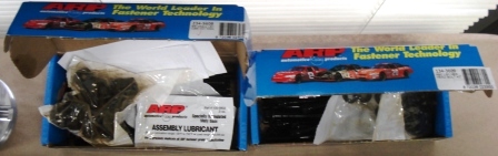

ARP Main Studs
Timing Chain Set
Crank bearings
Pistons
Rods
ARP Rod Bolts
Bearings
Balancing

Gaskets, Seals
Crank pinning kit
Cam
Valve Springs
Hardened Pushrods
ARP head bolts

Twin in tank
60# injectors
Turbo:
As seen in pics, if you can read it on there lol.
Precision 76GTSH capable of max 1150HP

Depending on the heads and cam you run I would guess 7-800RWHPMAX with the T76 @15LBS on a 408. You should be able to get near 1000 with a larger PT88, and 20LBS. I don't really see the extra CI's making any more HP, it will just make it alittle easier. After playing with a T76 on my 6.0L at high altitude, 15-16LBS is all it will make. I think you will be maxing that T76 at around the same boost on your 408 at sealevel. If your converter works really well, and everything is dialed in, I can see you running really low 11's, maybe even high 10's.
Dont forget this is an SUV and it weights over 5500lbs i have 24 inch rims on it. (100lbs per wheel/tire)so there is some MEATunder all four, so it should hook up a little. .lol
As far as maxing out the turbo. I have read specs on the turbo and it says its good for 1150HP. IS that not true?
I think you are just screwed cuz the high altitude. The guy that is doin the build says 20lbs easy from the 76. The 88 would bring lag problems wouldnt it?
