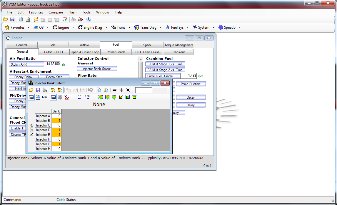

You could always just run 1, and tell the pcm they are all on the same bank, and run it after the merge.

I was referring to setting this table to the passenger side only (all 1s should be bank 2) and try it.
This table is used when using on motors with different firing orders (like when retrofitting an LSx PCM to an SBC or LT1). It tells the PCM which bank the injectors are on.
It should be ok with only 1 sensor, many GM V6s only use 1 pre cat O2 sensor.

i have never tried this. seems like it may make them fire incorrectly.

I don't think it should be an issue. firing order is hardcoded in the PCM, can't change it. This table *should* just tell the PCM which cylinders are using which O2 sensor.

its worth a shot i guess. worse case it floods a few cyl and you just shut it off.
