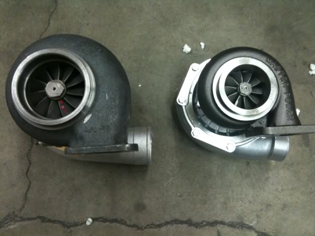

What is the exhaust A/R on this turbo. I'm scared to see what the BP is going to be on my PT88 with the .96 ar. I am sure its gonna be as bad if not worse. This is a great write up by the way thanks.
Originally Posted by smokeshow
PT88 has a 94mm turbine inducer IIRC.
A/r is just a ratio, not a size Both of these are T4 .96 a/r, right is a Masterpower P trim and left is a PT88 . The PT88 exhaust flows WAY more then these Magnums.
That 88 has proven to be a great turbo. A pretty penny.
Just like the compressor side not all 76's are the same. Nor flow the same.
Good info.
