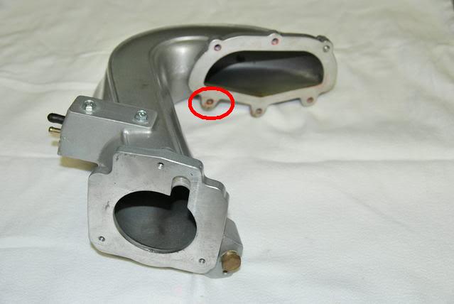

Here is the hole I am speaking of.
The previous owner of the supercharger made a plate and had it heli-arced onto the original J-tube. (the picture attached is not of mine)

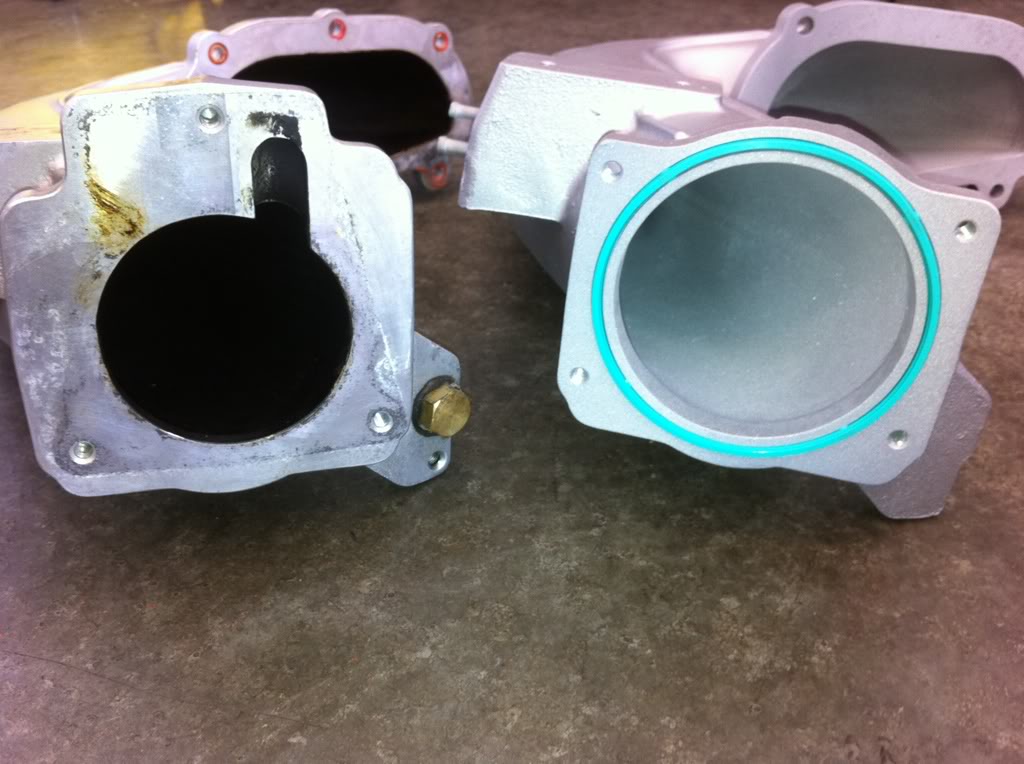

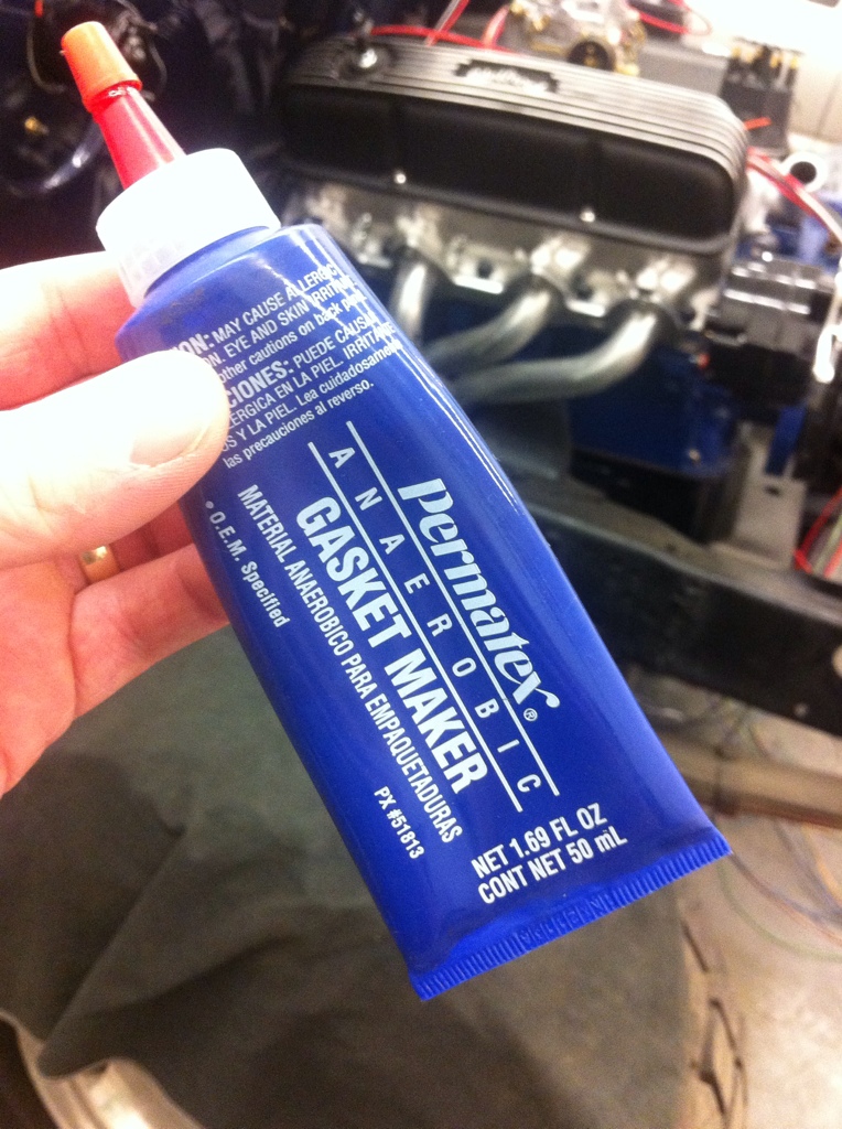

Don't bother trying to put a bolt there. Clean both surfaces really well, and get a tube of anaerobic sealer. The 90mm J-tubes only have 4 bolt holes, 2 on top, and 2 on bottom. Only pic I have doesn't show all of that flange, but you get the idea.
