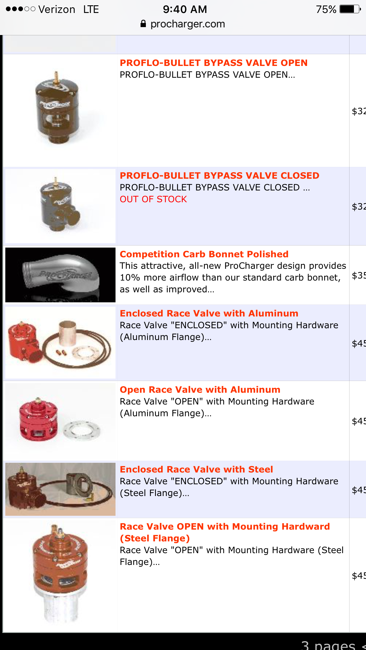

Hello guys and gals can someone please tell me what the difference is between the black bypass valves and the red ones will I gain any performance of is it all sound and looks?

I didnt bother and just ran a Tial 50mm

Sorry kind of new to this you can run bovs on a Procharger??

yes thats what those ones you posted are

The black bypass valve re-circulates the air, the red cents it to atmosphere.
The red one or a blow of valve is gonna have the cool sound you're looking for!

I ran it, but its more or noise thing. If you run super high amounts of boost it would relive the system faster, but at low boost nothing other then sound.
They called it a surge valve, basically a vacuum line that runs in and holds it open till you hit the gas. Then it closes based on lack of vacuum, until it sees vacuum again. The red one is adjustable how far the valve opens, from just a little bit, to full range.

Ok guys thanks a lot 450 bucks is a lot if it's not gonna help performance think I'm just gonna put together a meth kit thanks
