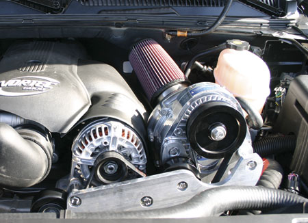

Take a pic of the engne bay so we can get a better idea of where its at???

Ok looking at the pic from the older thread id say you have a wet filter..Check the to make sure the seal/gasket is still in place below the wiper to seal the hood to the cowl..
K&N/afe make a slip on cover to block water on cone filters..
https://www.performancetrucks.net/fo...gmtruck-lg-jpg

ok, that is the seal referred to above. I get it now. I was thinking about a filter sock on the way home as well. My real preference would be to move the air intake to some other location, but the snow meth kit is on the left side where the air intake would go.
