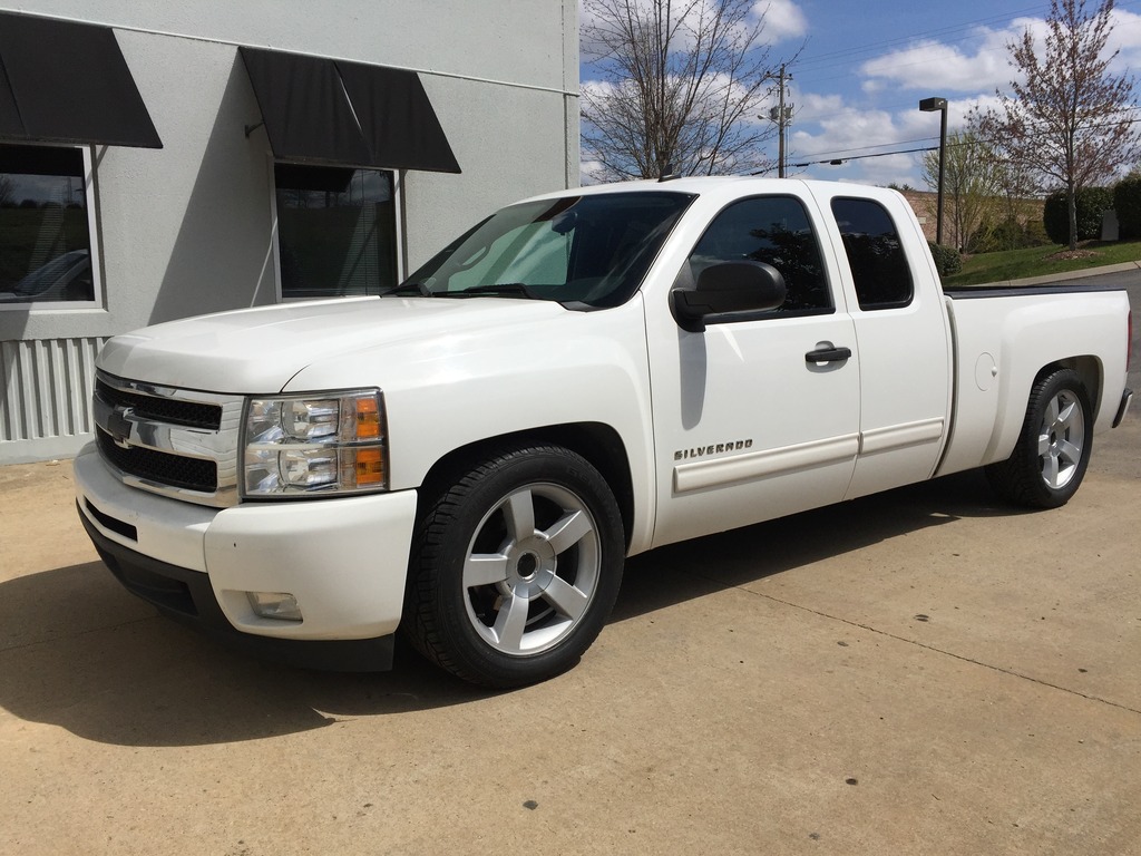

I figured we see not in the tranny swap and less on the locker swap. Maybe LT will chime in. Still looking pretty good with the replica Silverado SS in there now with it being lowered.

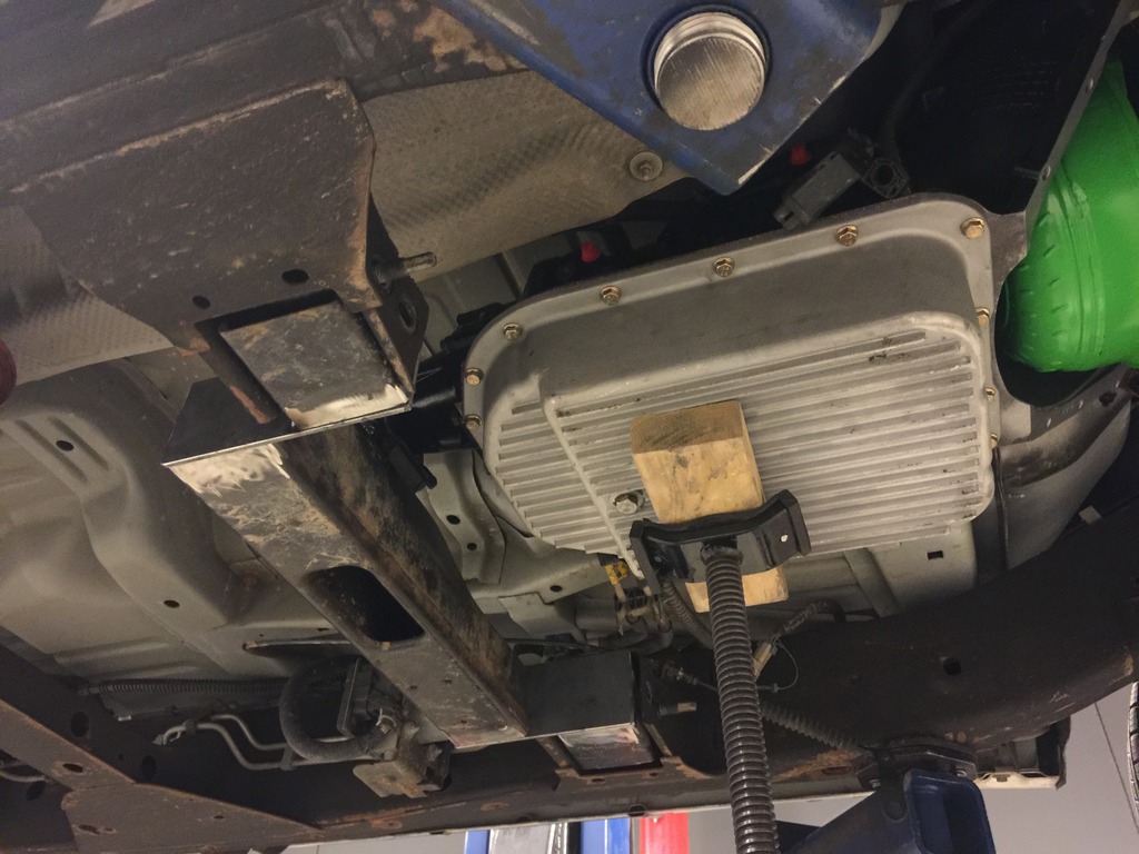

I did have to modify the crossmember to fit the 4l80e. The mount pad is about 4 inches farther back on the 4l80, so I cut and extended the crossmember. This is what is looks like mocked up in the truck prior to finish welding

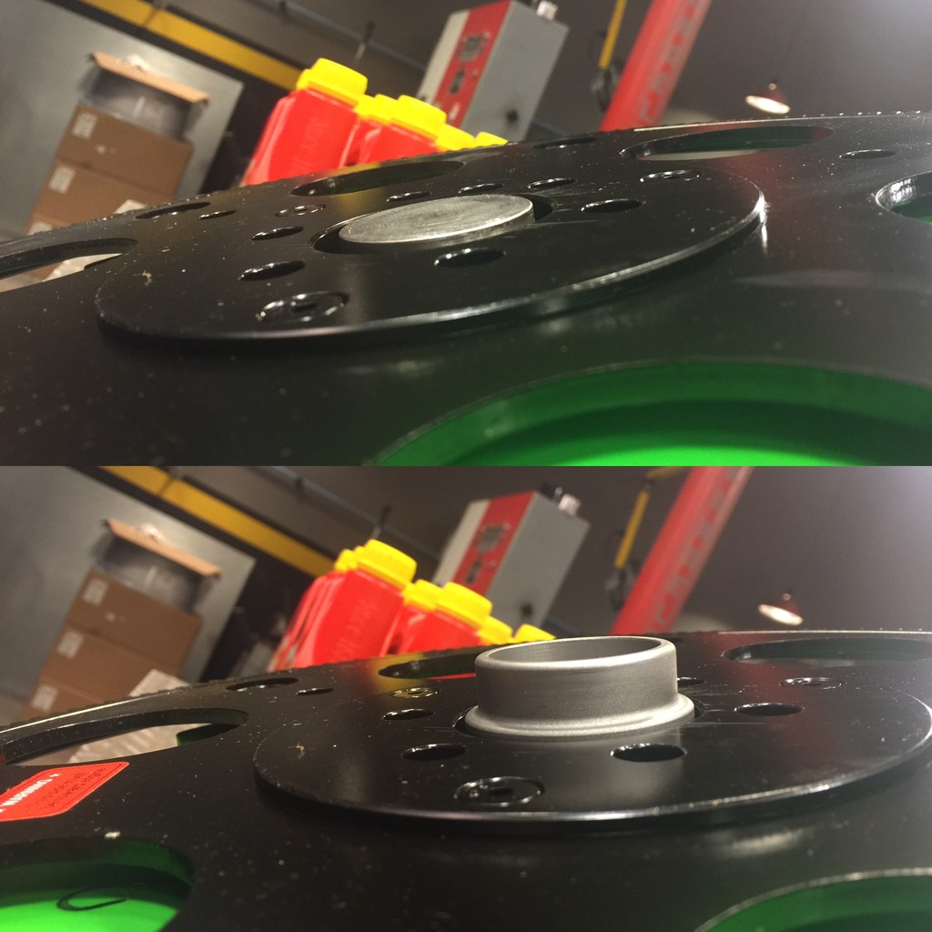

On the new torque converter, it came with a longer pilot. If you swap a 4l80e behind a LS engine with a stock converter, the pilot is 0.400" (i believe) shorter, so there is nothing to center the torque converter into the crank. Usually, people either use a crankshaft spacer from HD trucks, or companies like TCI offer the swap flexplates with the extender. Because of the longer pilot on the Monster converter, we did not have to run the spacer. I also know most companies like Circle D and Yank offer the same thing. There are a lot of detailed 4l80e swaps on PT that go over this.
You can see on the bottom of the pic, the spacer would stick out way too far, and not allow the converter to bolt up properly to the flex plate.
The 2wd 4l80e is a few inches shorter than the 6l80e if memory serves me correctly. (its been a few projects between then and now...) I have seen a 6l80e to 4l80e 4wd swap on PT.net, and I think on the 4wd version, the cross member is much closer.

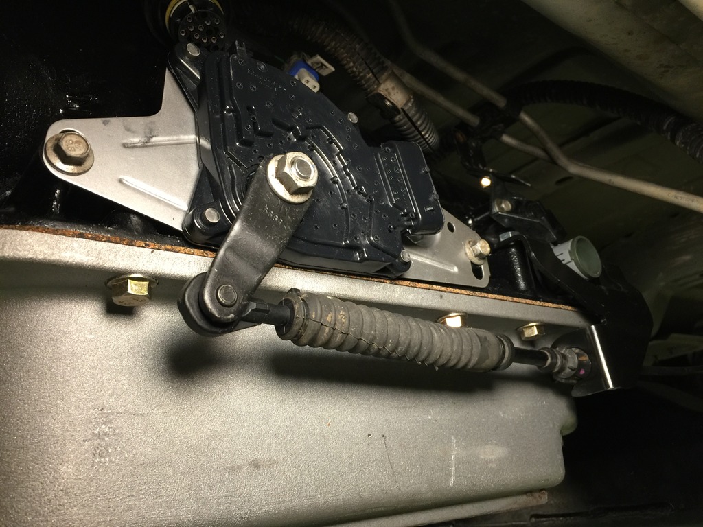

The 4l80e is shifted by the stock 6l80e cable, attached to factory 4l80e brackets. All I had to do on the shift select arm, was spin it 180*, and everything lined up perfectly.

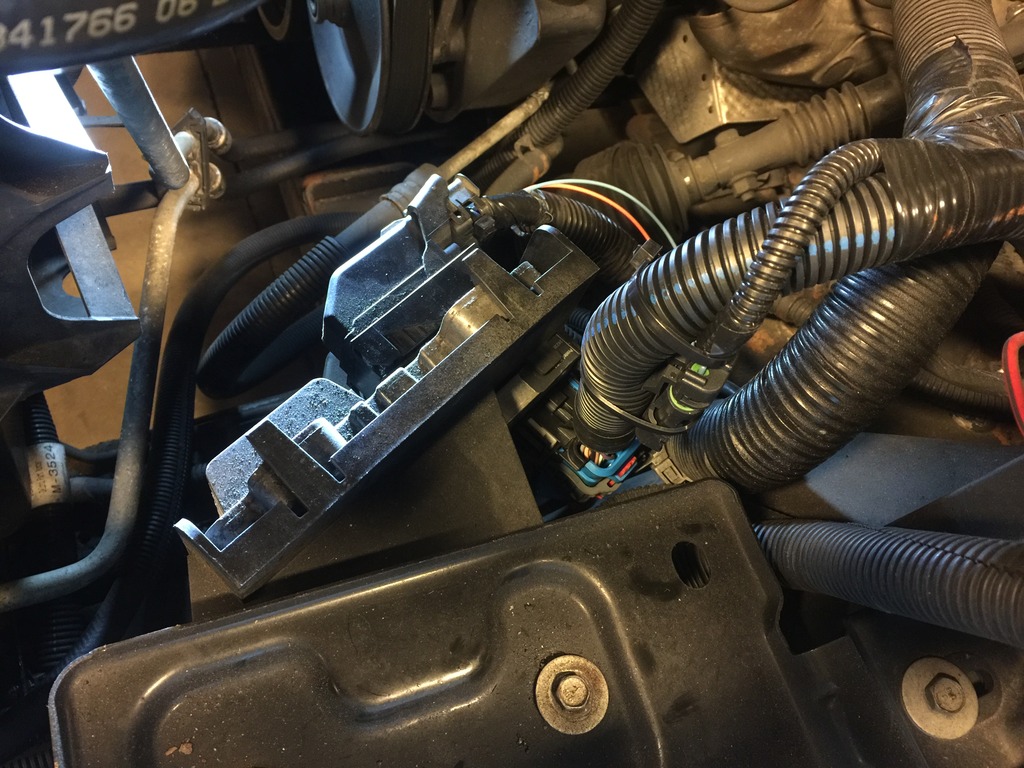

the new TCM already had a bracket behind the ECM, and the PCM of NC harness worked perfectly.
