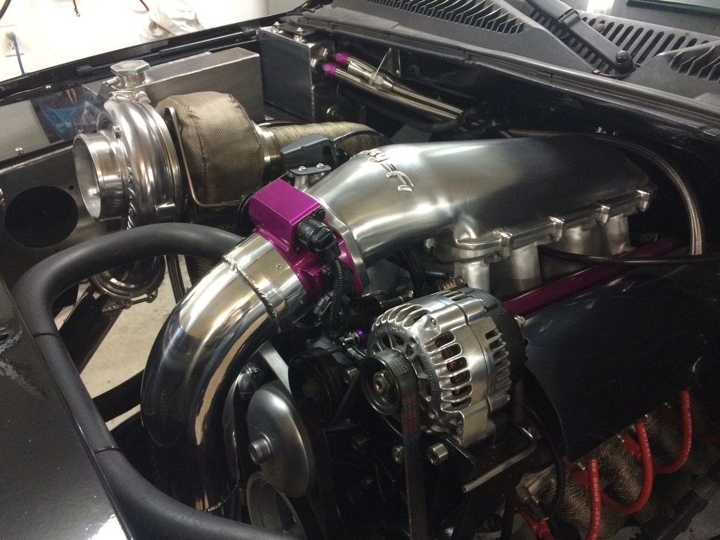

Slowly but surely making progress

Looks good man, share the details.
Working on putting a build thread together but so far stock bottom end 4.8 besides rod bolts, ARP Studs, Tick Performance Stage 1 cam, Lunati Lifters, BTR trunnion kit, BTR dual valve springs, BW S475, LS2 Fast 102 w/ FAST rails, Katech Tensioner, CX Racing hot side
In the process of getting the cold side plumbed, then would like to get it tuned just to get on the road then when spring rolls around the regulated return system will get done along with tranny, plan on ditching the 60e for maybe an 80 or turbo not sure yet
BTW Pat do you have the ability or know anyone available to SD tune?

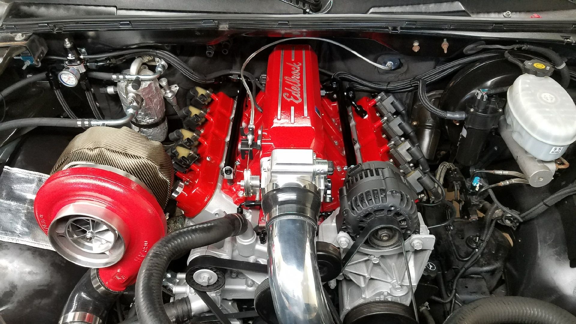

its come a long way, but Im satisfied with it.
