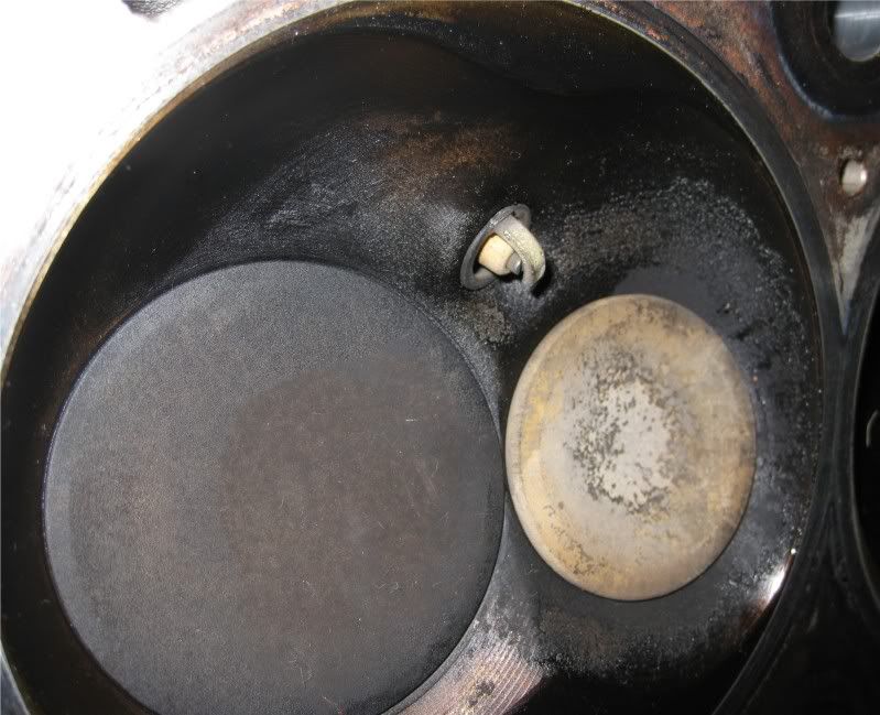

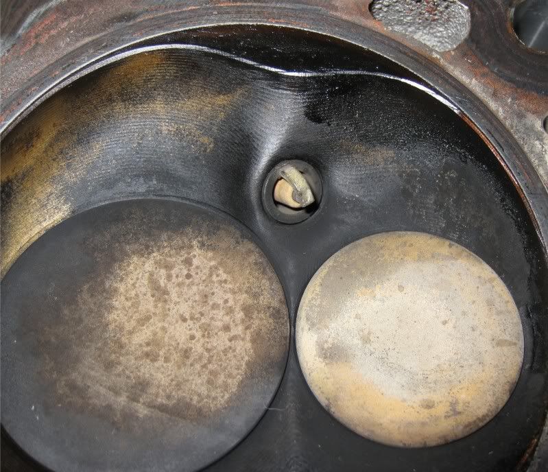

Here's a couple of pics of how the TR6's sit.

I would have thought you'd be running a 7 heat range in there. A TR6 is way too hot of a plug for the boost level you're running if you're doing it on pump gas. Anything higher than a 7 if I recall is only made in a non resistor form and can cause RF problems with the stock ecu's.

I run TR6 .032ish 8lbs boost on pump not a problem...most guys on the LS1 site run the TR6 or BR7EF..i am seeing either one work...

I have TR-6 in my setup, but I am only at the 14PSI mark. These were recommended to me by numerous reputable tuners. FWIW I have had no issues in the last 8 months with them.
