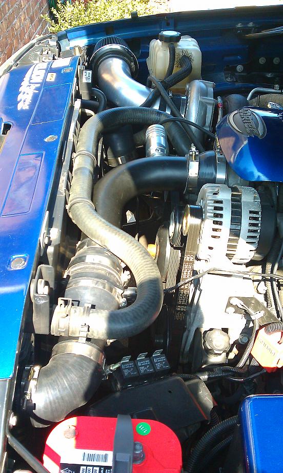

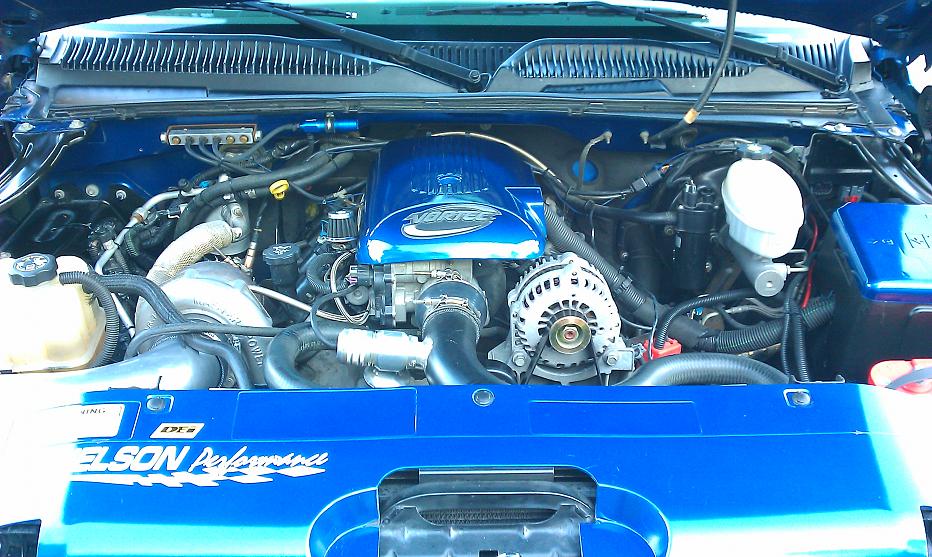

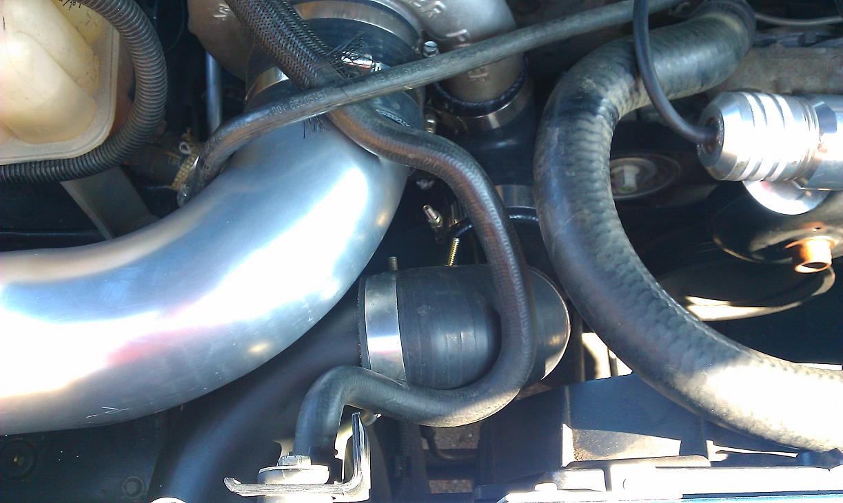

i'll give you some. not the best pics. mp70 non-intercooled kit. put my own intercooler kit on, but kyle makes a nice intercooler kit too.

black4.8 why did you not reclock your turbo to have less bends in the cold piping? Also I am curious where you mounted your IC because I am planning on adding one to my truck soon.

it made it easier hooking up the pipe. didn't have the right pipe and coupler to do it. its not hurting anything, just looks kinda funny. been meaning to fix it just haven't had time. intercooler is mounted behind grill. its a 12"x28"x3" fit nice and have a lot less cold piping than between the frame rails. not having tranny cooler or ac condensor helped w/ space.
